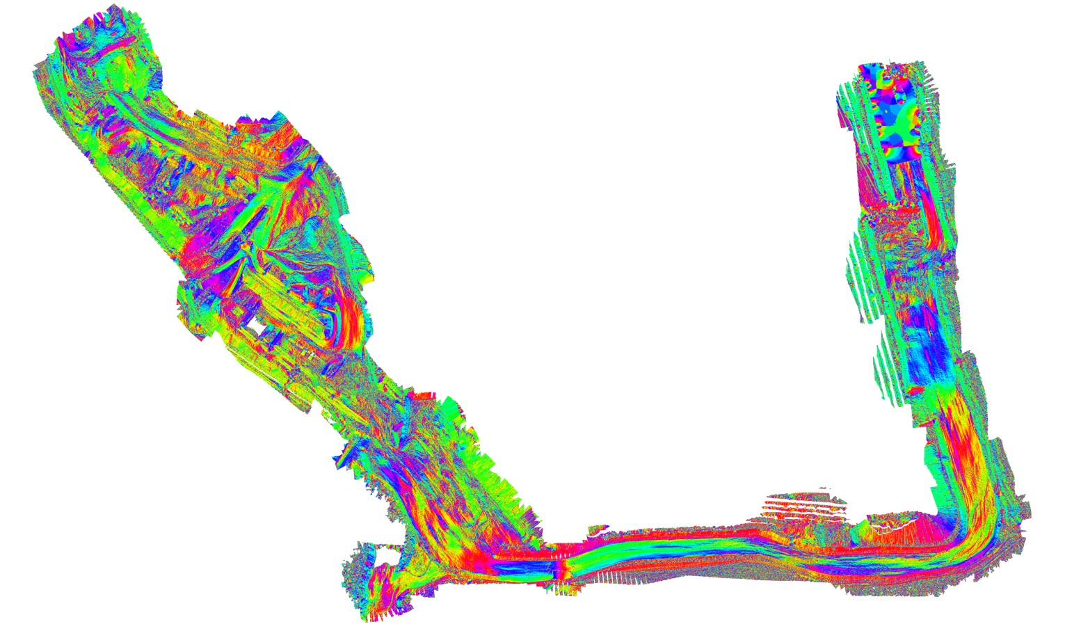

- Raster created using commandline (incorrect)
- Dip using commandline.jpg (287.54 KiB) Viewed 3870 times

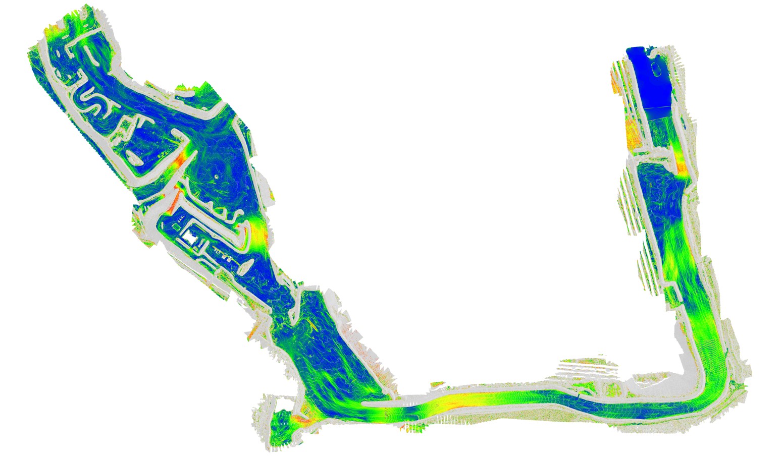

- Raster created using application
- Dip using application.jpg (218.22 KiB) Viewed 3870 times

I believe it's simply because the 'SET_ACTIVE_SF' doesn't apply to the rasterize tool. In this tool, you have to manually select the 'active layer'. And that's not an option of the command line interface yet...
