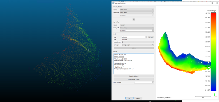

Hello all,
I'm new to CloudCompare and I would like to understand the Compute 2.5D volume tool using as source "constant" and a point cloud. I have a point cloud of a slope that I would like to know the volume. When I compute the volume of this point cloud with the "constant" I have an "added volume" but I don't understand to what is this constant based to calculate this volume and to what this "added volume" corresponds. Can someone help me understand what is this volume ?
Thank you very much in advance!
Re: Compute 2.5D volume - understanding
The 2.5D Compute the 'vertical' distances between the points and either another cloud, or a constant plane (Z = constant = 0 in your case). Then it sums the individual volume contribution of each point. As you have set the constant plane as 'after / ceil', the distances are inverted and are probably negative.
And it's 'added volume' if the volume is positive (i.e. the points are above the constant plane) or 'removed' if it's negative.
See https://www.cloudcompare.org/doc/wiki/i ... .5D_Volume

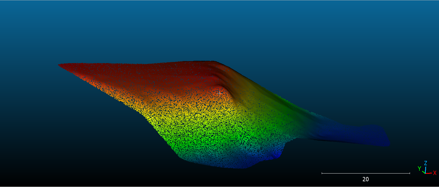

If you have dense pointscloud, apply 2.5D volume
but if you do not have dense pointscloud , the steps are :
1- Meshing (to gap between 2 points (linear averaging )
2- If necessary, clean the mesh to be a concave hull not a convex hull (something only humans can do not AI ??)
3- Sample points the mesh (5 million, bigger is better )
4- Apply 2.5 D volume (use leave it empty)
Check attached example
Group.zip
(1.03 MiB) Downloaded 1101 times
DA523
Posts: 186
Post by DA523 »
In the above example, the volume of pointscloud against constant plane z=0
grid step= 0.055
mesh sample points 10M
volume is 24,279.576 cubic units
