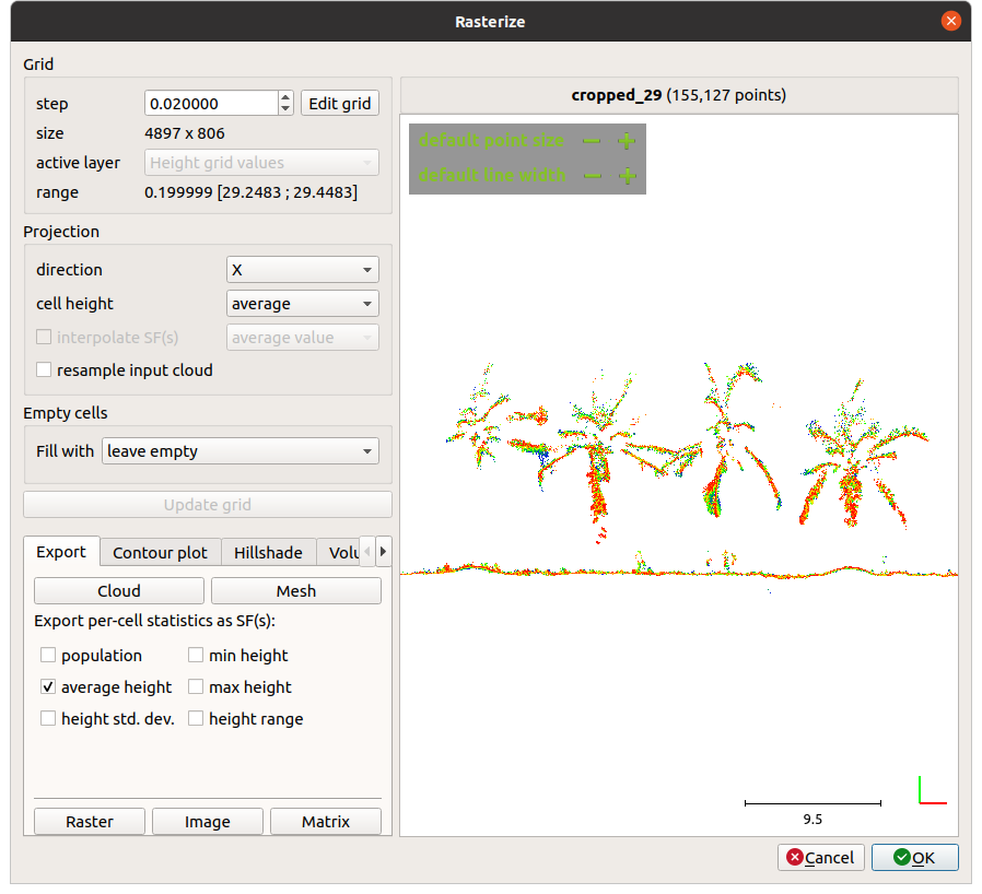

I'm trying to rasterize a pointcloud using the command line interface.
Using the GUI version, I get a nice colored .png image

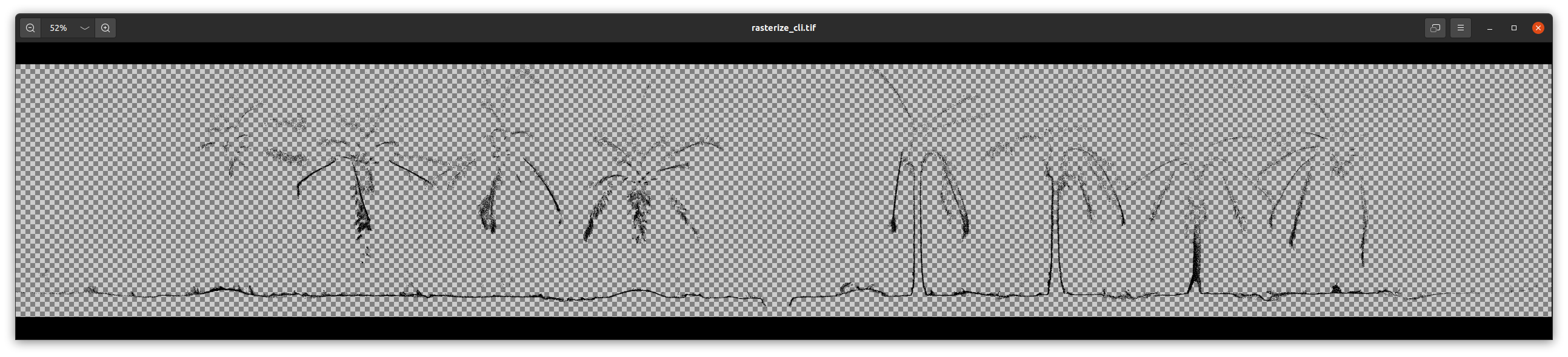

However, using the CLI, I get a monochrome .tif
The command used was:
Code: Select all
CloudCompare -O my_pcd.pcd -RASTERIZE -GRID_STEP 0.02 -VERT_DIR 0 -OUTPUT_RASTER_RGB
How can I get something similar to the GUI version using CLI? i.e. I want .png instead of .tif
Arif
Re: Rasterize via CLI
In command line mode, the Rasterize tool can only export rasters to (geo)tiff. And it will save the altitude of points as is, and not as RGB colors or anything. The colored display you see in the GUI version is the false coloring CloudCompare applies on these altitudes (or on the values of the active scalar field).
