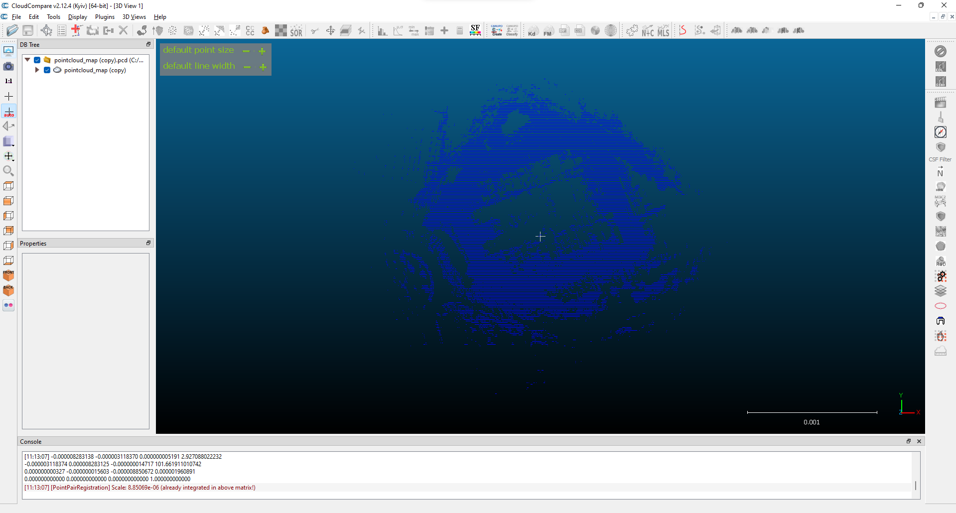

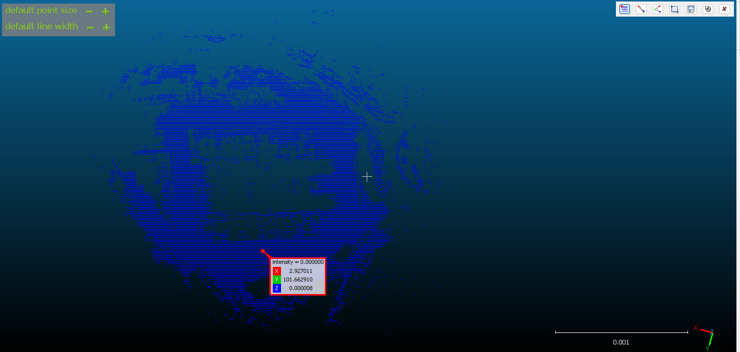

I just learned how to align one cloud with the real coordinates. When I finish pointing the coordinates, I click align and press Enter, it becomes like this.
If you notice, the scale on the right bottom becomes smaller.

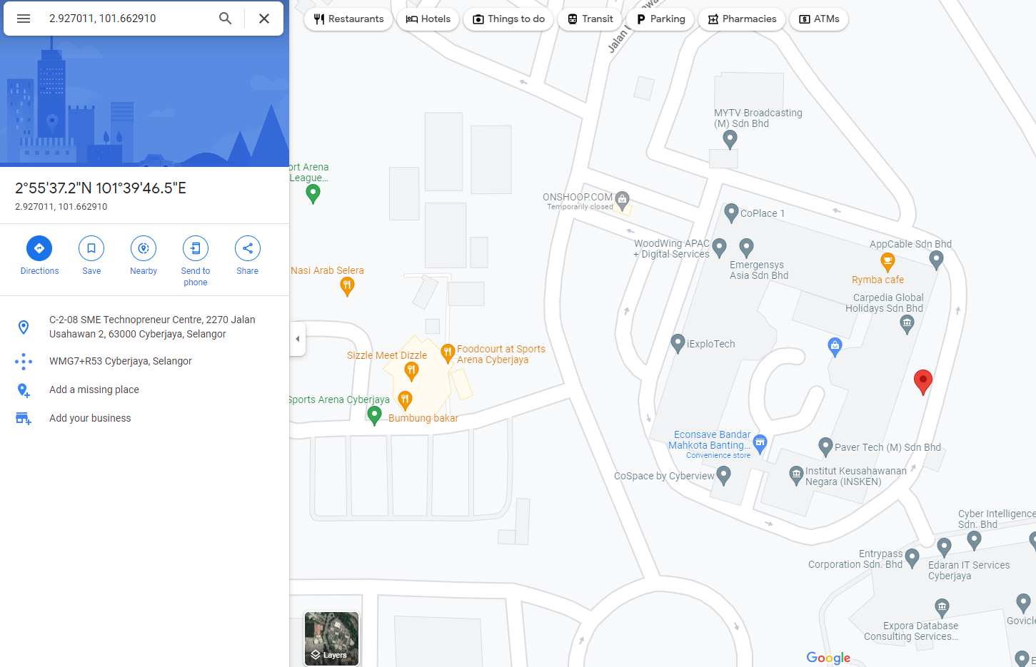

And global coordinates that I align the point pairs are:
2.92782083, 101.66214713
2.92698574, 101.66187756
2.92664684, 101.66282667
2.92748175, 101.66301075

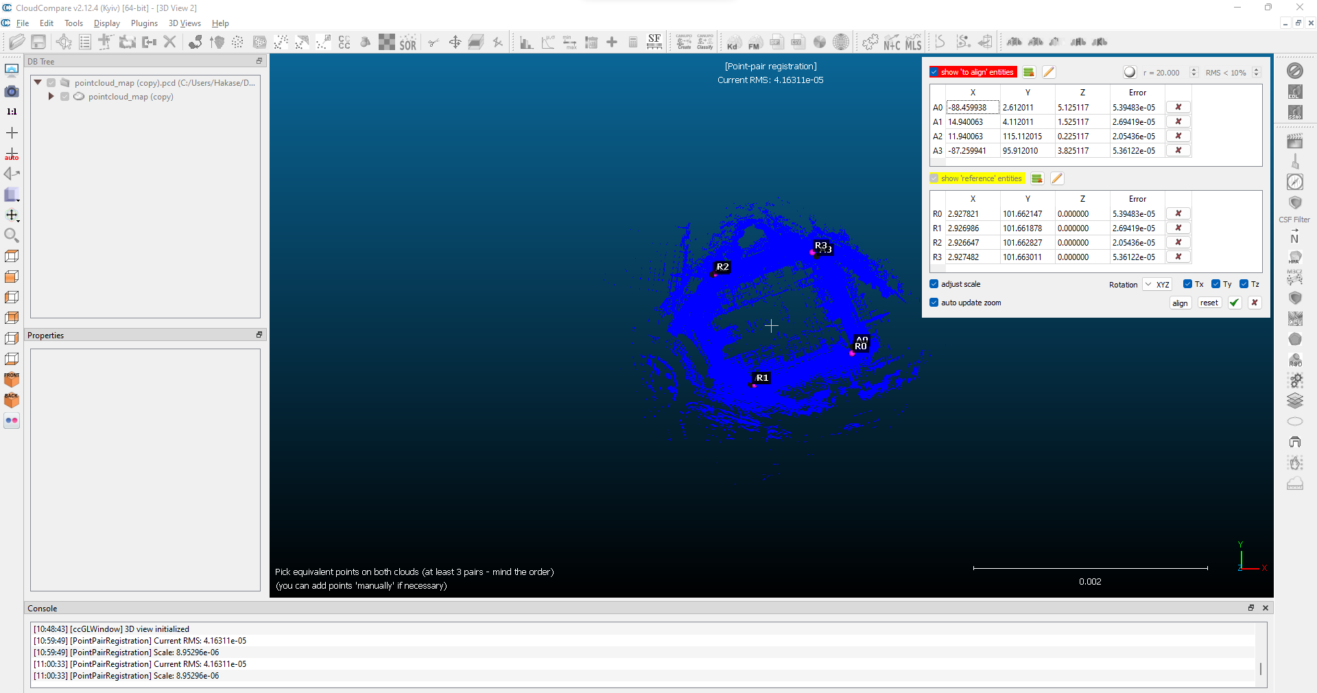

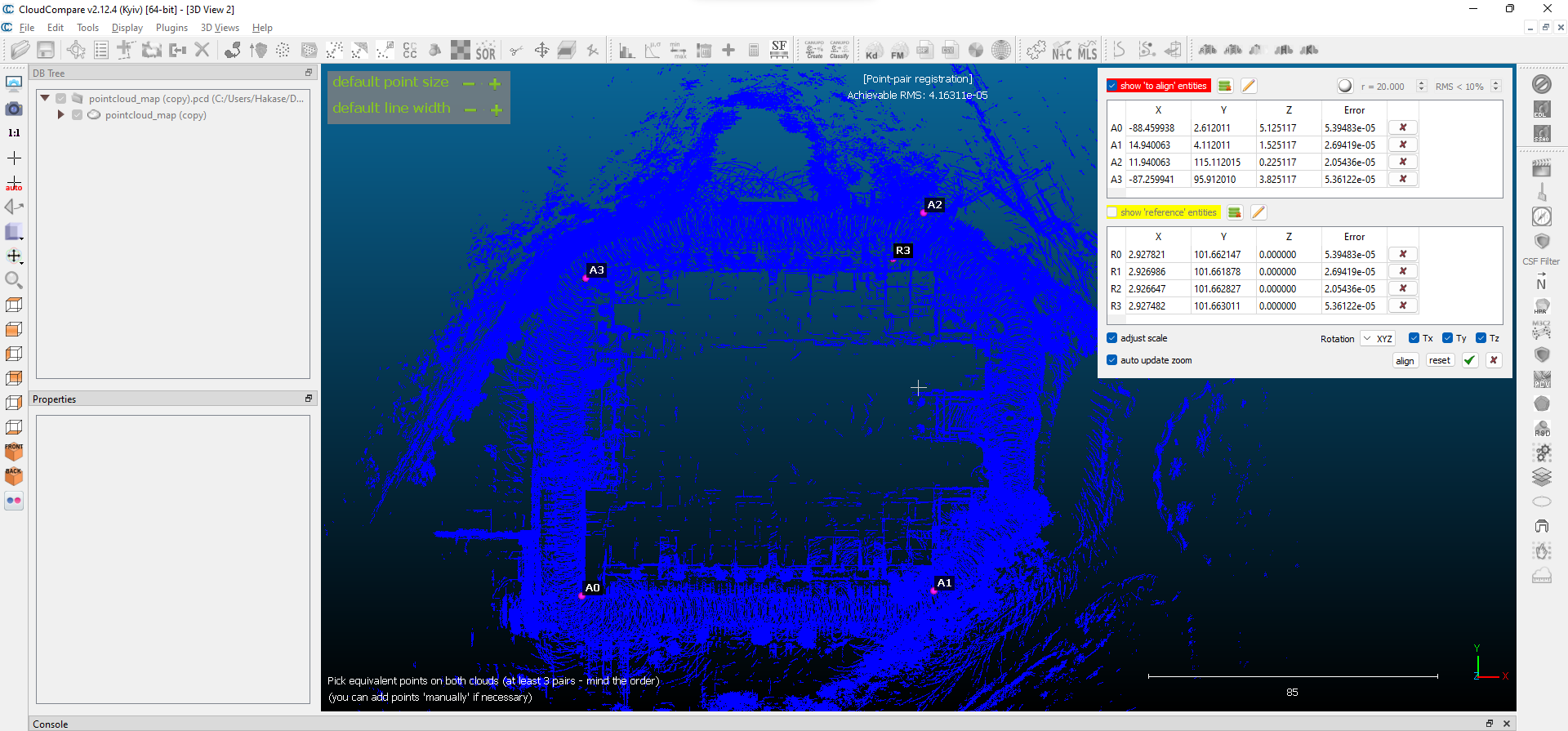

Below I attached my screenshot of aligning the pair points.
If you notice, the scale now is 85. This happened when I click align. It rotates the PCD and the scale becomes smaller. The scale is now 0.002
Re: PCD data scale become smaller
Ah, I understand now. Since all the Z coordinates of your reference points are 0 (= 2D points), and you tell CC to scale the align cloud (3D) to best fit the points, it ends up rescaling the aligned points with a ridiculously small scale (so that 'P.z * 0 = 0' basically).
You can't align 3D points with 2D points this way... You would have to make a clone of your cloud first, then flatten this clone (with 'Edit > Multiply / Scale' and use 0 for the Z coordinate only). Then align the flat clone with your 2D reference points. Look at the resulting matrix in the Console (F8) and copy it (CTRL+C). And eventually, you can apply the same matrix to the original point cloud with 'Edit > Apply Transformation' (and paste the matrix there, either with the 'clipboard' button or with the CTRL+V shortcut).

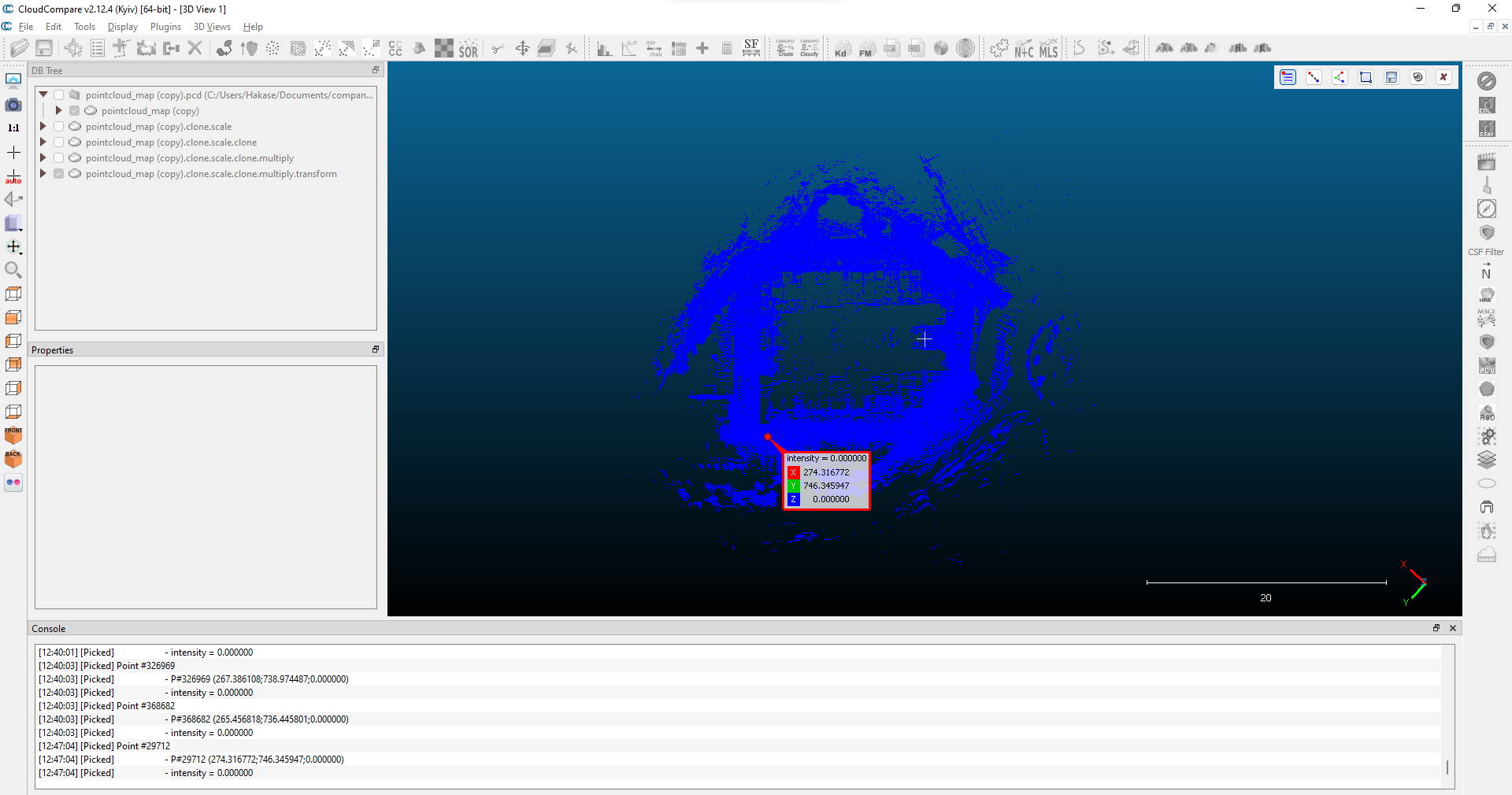

I've tried your method, but it seems the scale still become smaller. I recorded my step and posted it on Youtube, can you check and point out where I did my mistake? Here is my video link on Youtube.

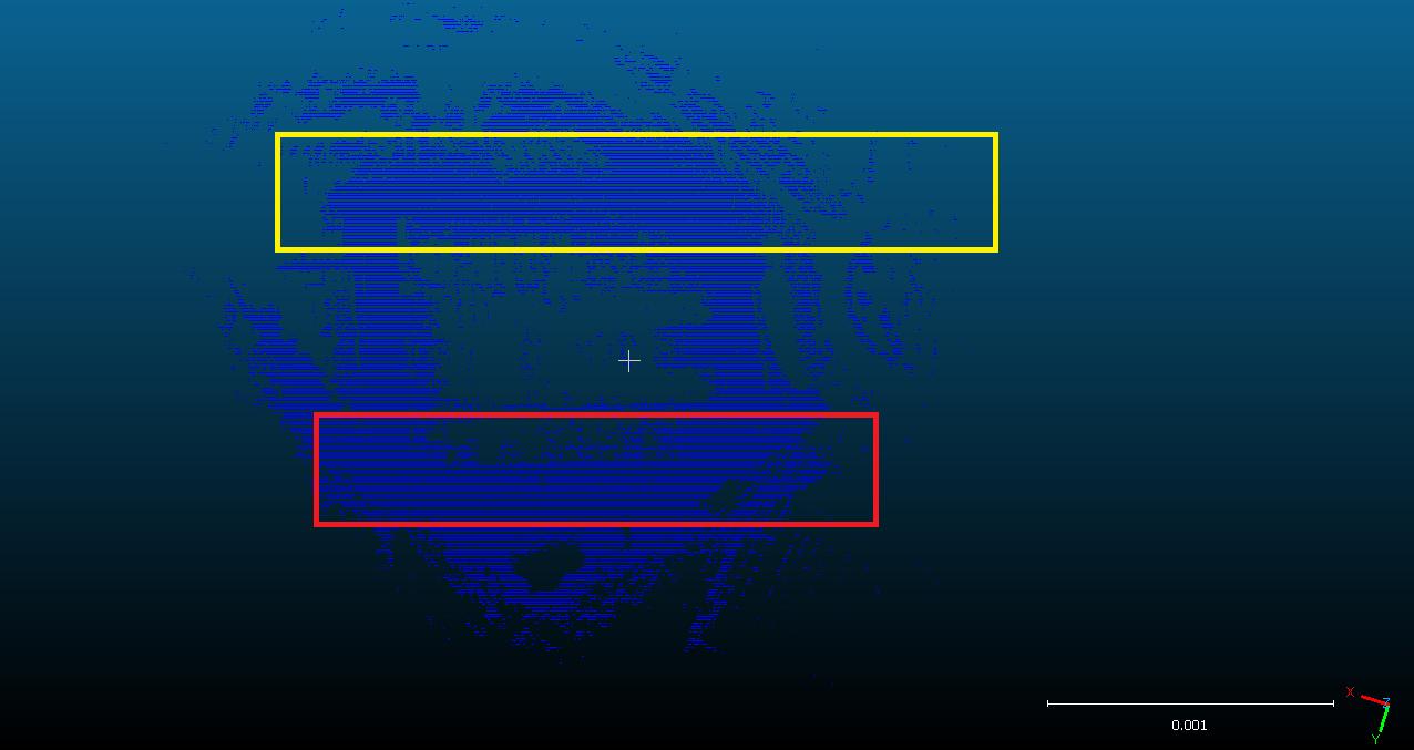

EDIT:

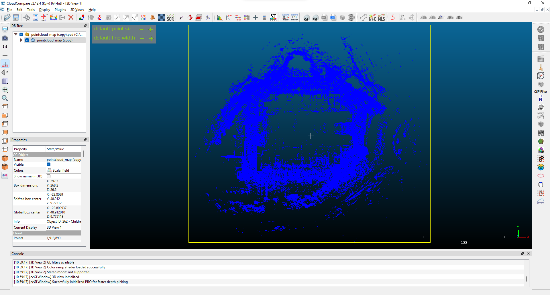

I just found out. The global coordinate after alignment and scale is a bit weird.
The picture above is after alignment. What I can see is the coordinates in the yellow box should be in the red box, and vice versa. But it's fine on the left and right sides. Do you know why this happened?

Oh, I think it doesn't really makes sense to use 2D angular coordinates to match 3D cartesian coordinates... The 'align' tool performs rigid registration, and I'm not sure that converting from cartesian to angular coordinates is particularly 'rigid'.
The other issue, once again, that the resolution of the 4 pairs of GPS coordinates you picked in Google Maps is actually very coarse (something bigger than 10 cm in average I believe). You would need more digits to get a reliable result (an angula resolution that would be equivalent to mm accuracy I guess).
At least for now, if you want to make things a little bit better (visually) and have a better feel of what's going on, you could truncate the coordinates when doing the registration so as to limit the numerical incaccuracy:
2.92782083, 101.66214713 --> (- 2.9) * 100 = 2.782083 / (-101.6) * 100 = 6.6214713
2.92698574, 101.66187756 --> 2.698574, 6.187756
2.92664684, 101.66282667 --> 2.664684, 6.282667
2.92748175, 101.66301075 --> 2.748175, 6.301075
Then you can manually scale and recenter the resulting cloud (with 'Edit > Multiply / scale' for divide by 100, and then with 'Edit > Apply transformation' to translate the cloud of X = +2.9 and Y = +101.6.
I would be interested to see what's the result in this case. But I believe the result will still be off due to the metric/angular projection, and the limited angular resolution of Google Maps GPS coordinates.
