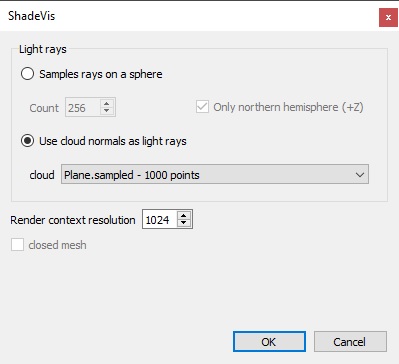

Maybe you could use the 'PCV/SahdeVis' plugin?
This plugin is used to simulate the quantity of light that each point of a cloud receives, as if it was under a dome of light (and the points are occluding each others). That's the default behavior, but you can also use a secondary point cloud to specify the light directions (only its normals will be used). So you can simply create a plane entity on top of your cloud, with the normal pointing down, and then sample a few points on this plane. Then use the resulting cloud:
(you can probably use much less points/rays if there's only one direction, 10 would be sufficient)

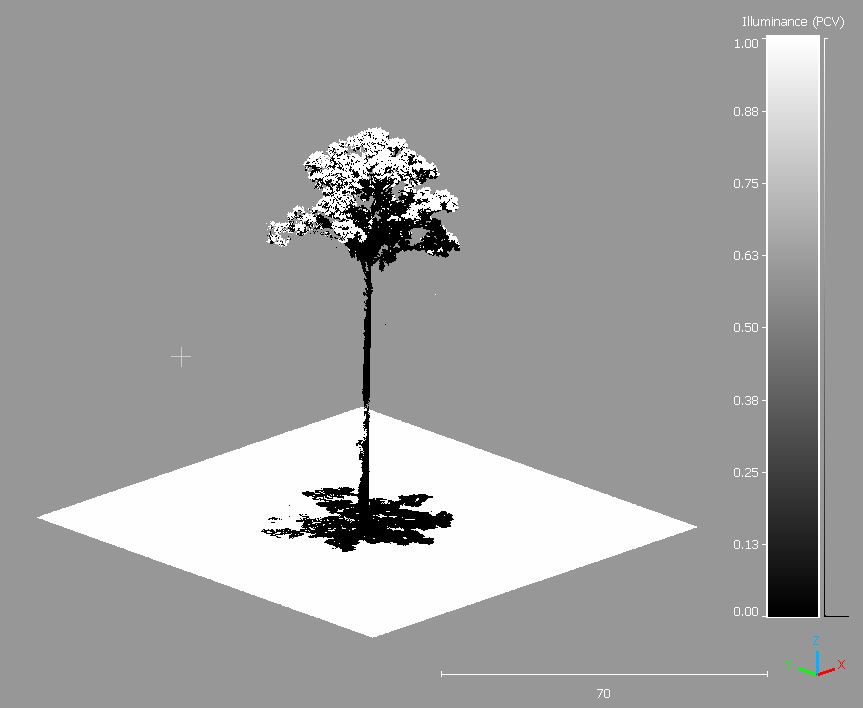

And you'll get a scalar fields with the 'illuminance' of the points, that will let you select the points in the shadow of the others:

Thank you very much Daniel, it works flawlessly!
