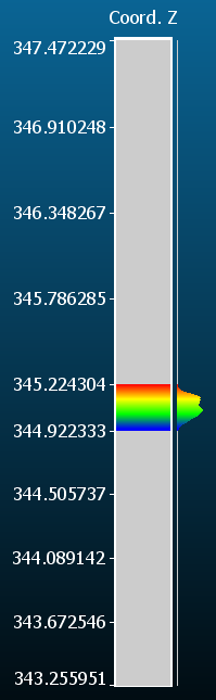

I am having an issue with my color Scale. I am working with some very precise scans and attempting to discern between some very small differences in height. I had to change the range of the color to get it to display the way I desired but now the Color Scale just looks like this:
Color Scale.PNG (16.06 KiB) Viewed 19516 times
I was expecting the new ranges to fill up the whole scale so I could get a better Idea of what color corresponded to what height. Is there some way to do this, Thanks for any help and let me know if I need to give more information.

To achieve this result, you have to create your own 'custom' color scale (and not a 'relative' one, but an 'absolute' one). See https://www.cloudcompare.org/doc/wiki/i ... lor_scales
