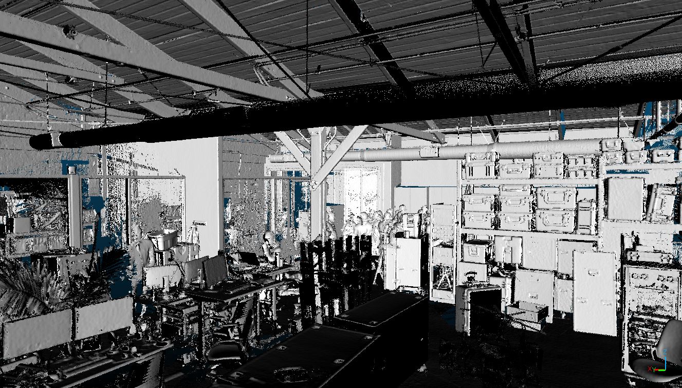

So what I did on my side:
- I removed all the spurious points outside of the building (you can either use the scissors tool or the Cross Section tool)

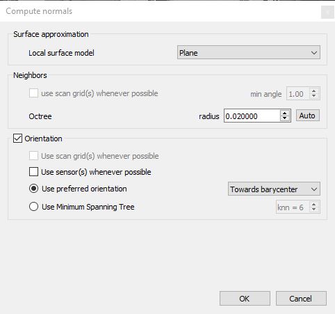

- I computed the normals with the following parameters:
(mind the fact that 'Use sensor(s) whenever possible' is disabled - instead I told CC to orient the normals so that they all point towards the center of the room, which is clearly a big approximation but probably more robust than the other heuristics in this case).

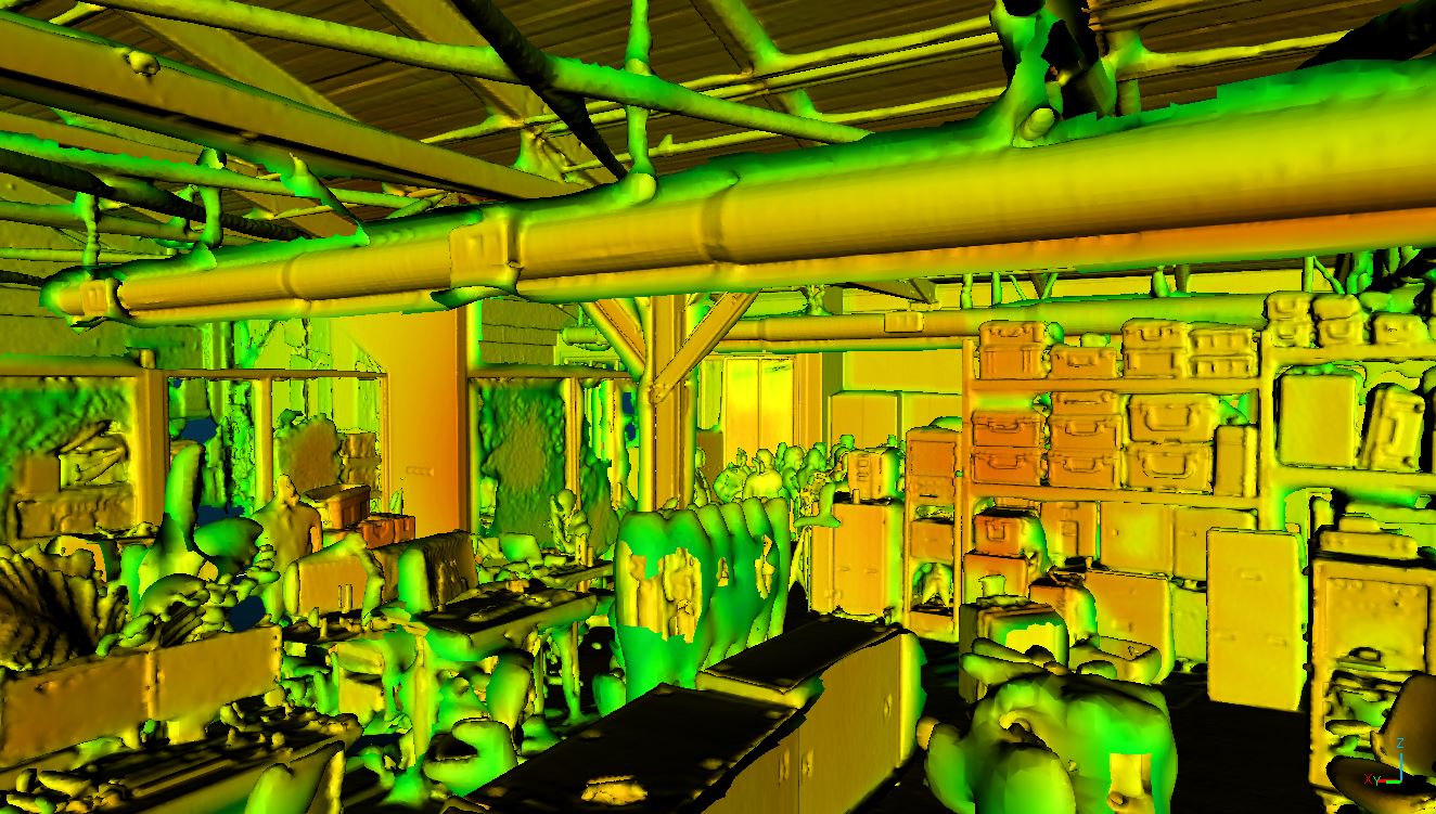

This gave decent results:
And you get a not so bad result with Poisson (considering the challenge ;):
