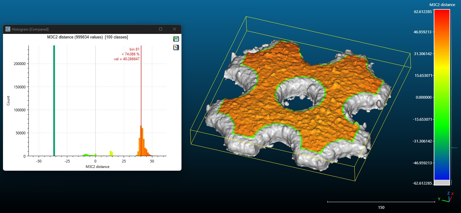

And for the records, here are the results with the M3C2 plugin:
(so about +40units for the top points, and -36units for the bottom points)

I used the provided M3C2 parameters and found that switching to Multi-Scale calculation mode and aligning the structures at the bottom was actually more effective for the intended comparison. Now, we do obtain logical scale values. thank you very much for the help provided.
