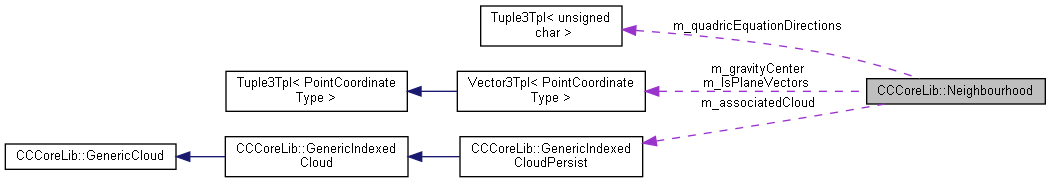

A specific point could structure to handle subsets of points, provided with several geometric processings.
Typically suited for "nearest neighbours". It implements the GenericIndexCloud interface by inheriting the ReferenceCloud class.
