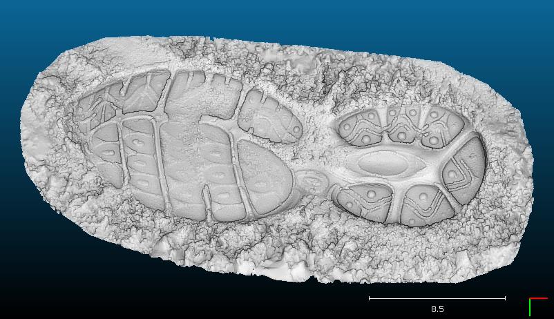

EDL is a real time shading filter that enhances very small features on blank clouds or meshes (i.e. it doesn't rely on any information apart from the geometry itself). As the SSAO shader, this is a faster alternative to normal-based shading.
EDL in action on a blank cloud
