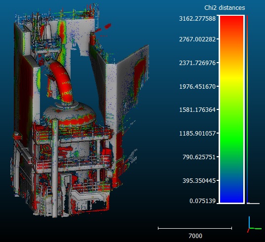

On completion, a new scalar field will be generated on the input cloud: 'Chi2 distances'. CloudCompare will automatically set the 'minimum displayed' and 'minimum saturation' values to the theoretical Chi2 distance that corresponds to the input parameters. This way all the grey points correspond to the points that follow the tested (noise) distribution. The others points are not likely to follow the tested distribution.
Local statistical test result

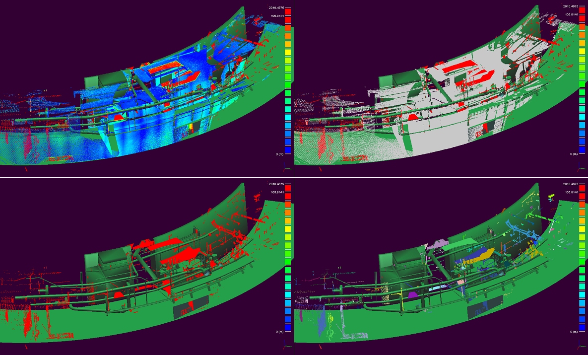

And from the filtered cloud you can extract Connected Components for instance:
Full workflow involving the Local statistical Test tool
