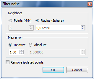

The user has to:
  • choose either to extract a given number of neighbors around each point (which is only suitable for clouds with a constant density) or to specify a ball radius (the ball should be big enough to capture at least 6 points typically)
  • input a max error (distance of the point to the fitted plane) so as to decide if a point is rejected or not. The error can be relative (as a factor of the neighbors re-projection error on the fitted plane) or absolute
  • eventually, isolated points (i.e. with less than 3 neighbors in the sphere) can be removed during the process
Noise filter parameters
