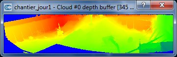

Clicking on the 'OK' button will create a new sensor object. A depth buffer is automatically generated and displayed by CloudCompare so as to let the user visually check the parameters. Note that the parent cloud of the sensor is used to create this depth buffer, considering the farthest point 'seen' by the scanner in any direction.
TLS sensor depth buffer

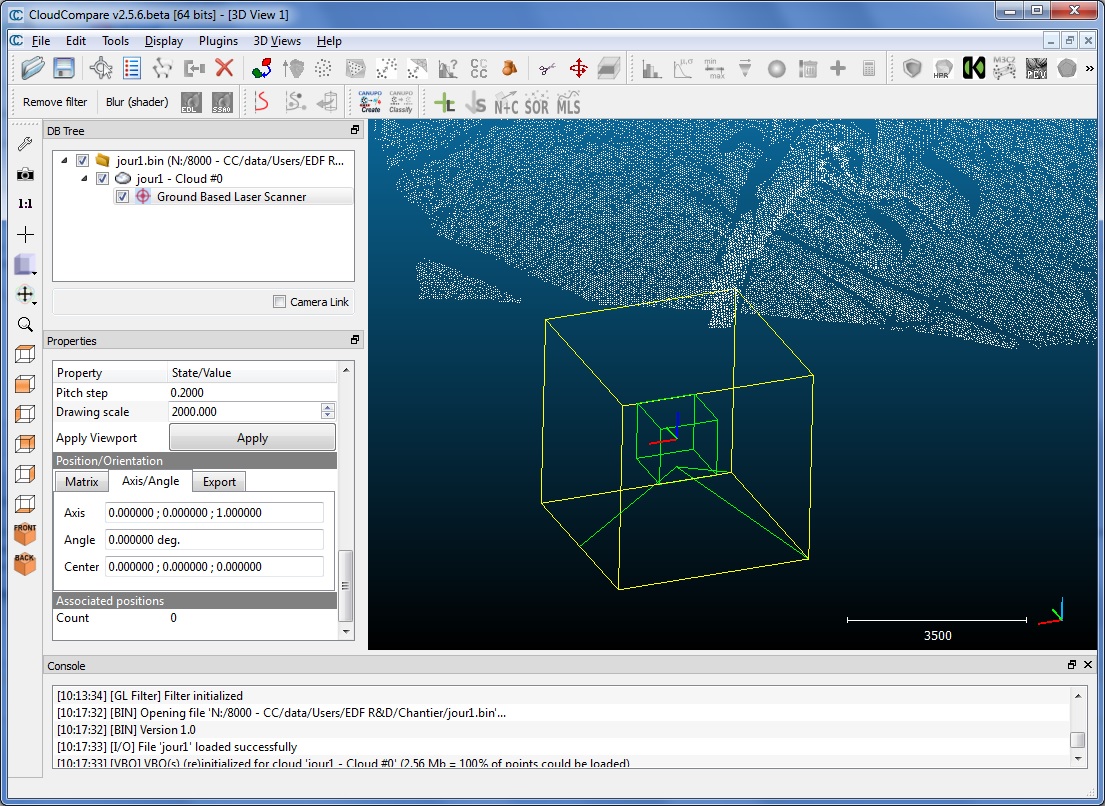

By default the sensor object is added as a child of the selected cloud in the DB tree. It is also visible in the 3D view (warning: you may have to change its 'drawing scale' - see the sensor object properties - to view it correctly).
TLS sensor entity (as visible in the DB tree and in a 3D view
