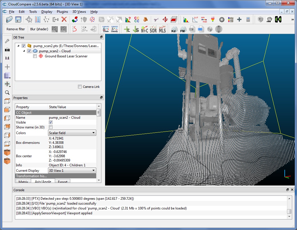

This tool is accessible via the 'Edit > Sensors > View from sensor' menu.
Description
Changes the current 3D view camera settings to match the selected sensor settings (bubble view mode).
Notes:
  1. the camera display mode will automatically be changed to 'viewer-based perspective'
  2. for GBL sensors, it may be necessary to manually increase the 3D view camera f.o.v. (see Display\Camera settings) so as to get a more realistic display.
Edit > Sensor > View from sensor example (Ground Based Lidar sensor)
