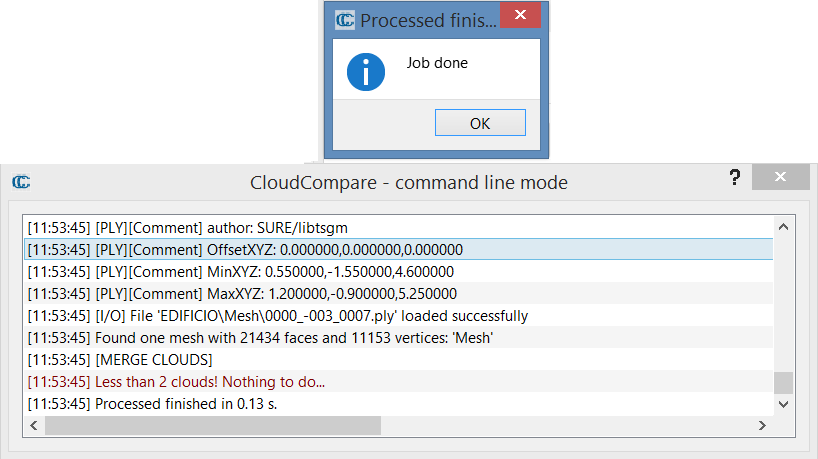

I tryed this command line:
CloudCompare -O EDIFICIO\Mesh\0000_0000_0006.ply -O EDIFICIO\Mesh\0000_0000_0007.ply -O EDIFICIO\Mesh\0000_0001_0004.ply -O EDIFICIO\Mesh\0000_0001_0005.ply -O EDIFICIO\Mesh\0000_0001_0006.ply -O EDIFICIO\Mesh\0000_0001_0007.ply -O EDIFICIO\Mesh\0000_-001_0006.ply -O EDIFICIO\Mesh\0000_-001_0007.ply -O EDIFICIO\Mesh\0000_-002_0006.ply -O EDIFICIO\Mesh\0000_-002_0007.ply -O EDIFICIO\Mesh\0000_-003_0006.ply -O EDIFICIO\Mesh\0000_-003_0007.ply -MERGE_CLOUDS
and I have the "Less than 2 clouds! Nothing to do..." as you can se in attached image.
Where I'm wrong?
Thank you.

This probably means that the PLY files contain meshes and not clouds ;)
