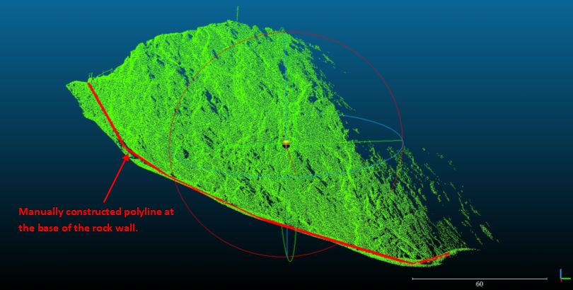

I have a TLS point cloud of a 100m high alpine rock wall. I’m only interested in the lowest section of the rock wall. Therefore, I’d like to remove all points that are farther away than, say, 10m from the base of the rock wall.
I manually drew a polyline that represents the base of the rock wall with the ‘Trace Polyline’ tool. Now I would like to remove all points that are farther away than 10m from this polyline. (Ideally, I would like to construct a virtual cylinder (with a radius of 10m) around the polyline and then remove all points that are outside of the cylinder).

Hi Daniel, thanks a lot for your quick response!
Drawing another polyline at the upper limit is not really an option for me, unfortunately.
This is what I am trying to do, explained in more detail: The lower limits (base) for all rock walls I am investigating in my PhD are glacier surfaces. I'd like to show how certain 'rock wall parameters' (e.g. surface characteristics, rockfall activity etc.) vary with increasing (vertical) distance to the glacier surface. To do so I want to classify my rock walls into 10m sections (-> Section 1: 0-10m, Section 2: 10-20m, Section 3: 20-30m,...). In the next step I could then calculate the 'rock wall parameters' for each of the sections. (Note: The glacier surface is not even, so I cannot simply use the z-values.)
I uploaded a screenshot of one of my rock walls. The glacier at the base of the rock wall is almost completely cut out already. The maximum vertical extent is approx. 70m (just to help your imagination).
Again thanks in advance!
Ingo
Ingo
- rock_wall.jpg (51.28 KiB) Viewed 12731 times
Re: Calculate Distance between Polyline and Point cloud
Quick trick that may work without a polyline:
. Create a raster of your point cloud using the Z direction, using the min elevation and "spatial resampling option" at a grid size commensurate with your problem (e.g., 0.5 m for a glacier face should be ok). His should create a "dummy" point cloud with very few points that are the base of your cliff sampled roughly every 50 cm. There might be some odd points high up if your cliff as overhangs that are larger than your pixel spacing but this should be easily cleaned manually.
. Then use a C2C calculation using the "base cloud" as a ref, and tick the option X,Y,Z. You'll be able to know for each point of your cliff the distance to the base (either the absolute distance, or the vertical difference).
Hope this helps
Dimitri Lague
Hope this helps
Dimitri Lague
Hi Dimitri,
thanks, this is a very nice workaround that works perfectly well for me - Thank you very much indeed!
(I could also skip the step of creating a raster and simply cut out the baseline of my rock wall, that's a pretty quick procedure actually.)
