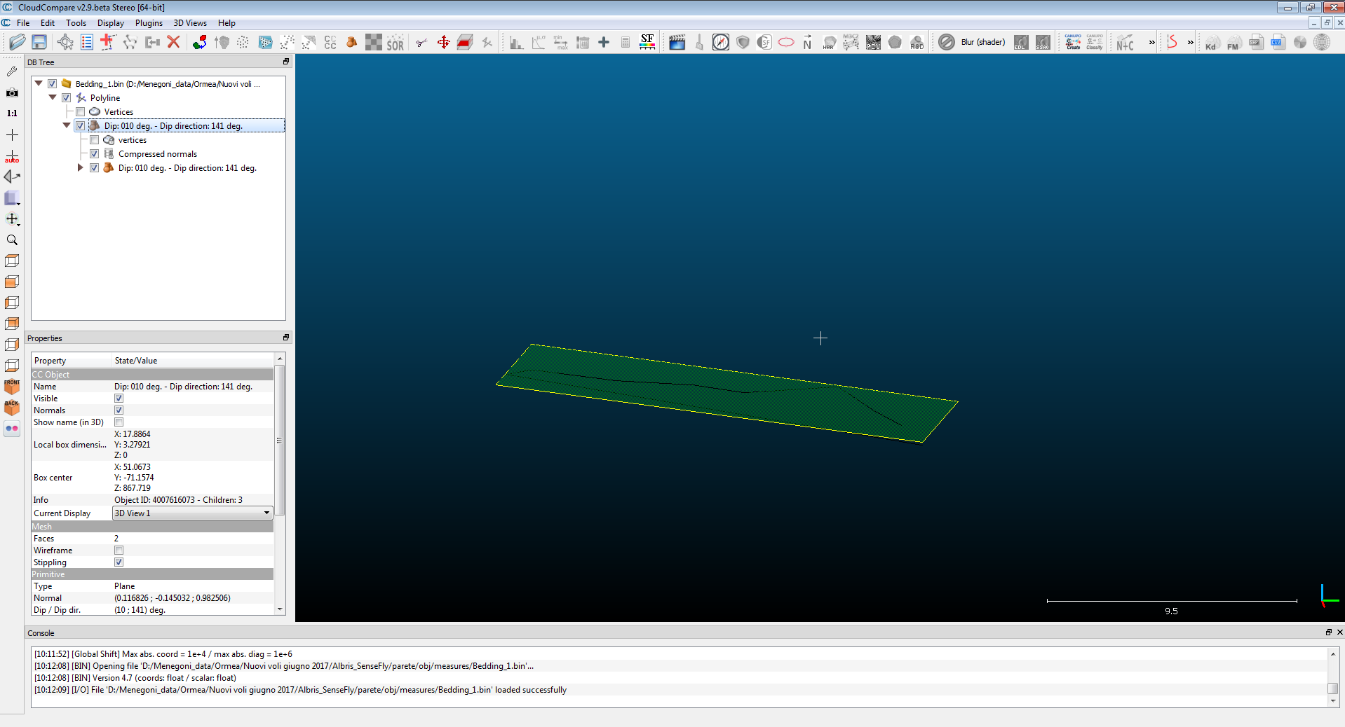

(1) when CC fits a plane, it shows the local dimesion of the plane (that I need) in the plane properties window (X: 17.8864, Y: 3.27921, Z: 0) (fig.1);

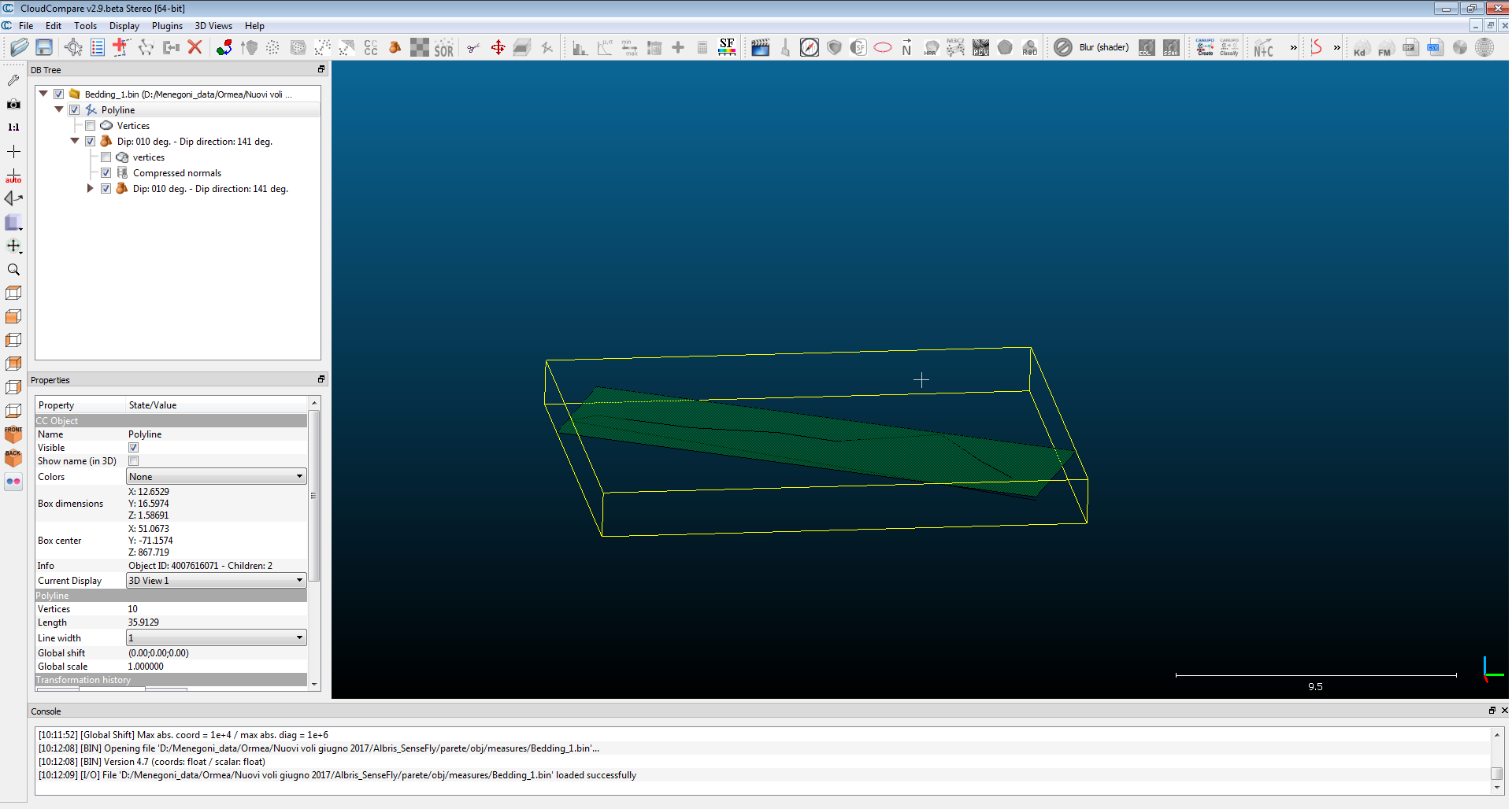

(3) whereas I can undestand the value of surface, that seems to be the product of the local dimension of the plane, I cannot understand the value of Horizonal and Vertical extents, that seem to be also different from the dimension of the bounding box of the fitted entity (fig.3)

- fig.3 bounding box of the entity (polyline)
- fig.3.png (117.65 KiB) Viewed 7418 times

- fig.1 properties of the fitted plane
- fig.1.png (100.82 KiB) Viewed 7418 times

- the plane width and height are really the length and width of the rectangle
- the bounding-box extents are always expressed along the main directions of the current coordinate system (X, Y and Z)
