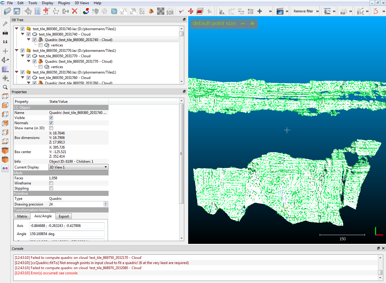

See attached, a screenshot of the current state of my project.

- c2m_bacth.png (223.44 KiB) Viewed 1923 times

Well, actually you only miss the option to generate the quadric via the command line. Otherwise you would be able to make a script that calls CC in command line mode for each cloud, generates the quadric and then launches the distances computation.
Adding this option to the command line tool is relatively easy if you have some programming skills (or someone around you). Otherwise I don't see how you can automate this task.
If this is not super urgent, I could add the option myself, but I really can't promise you on a short term.
