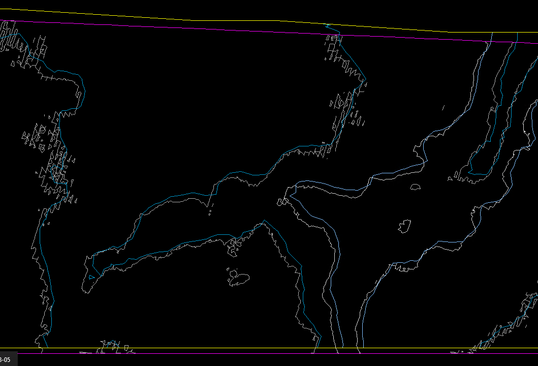

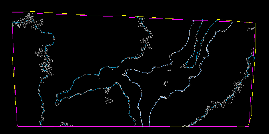

those contours are from TIN surfaces in AutoCAD that use the 5 m and 10 m average raster grid clouds generated in Cloud Compare. I did not generate the contours in Cloud Compare.
The shift I applied is to subtract half the grid spacing from both the X and Y values. So 10 m grid = subtract 5 m from both x and Y.

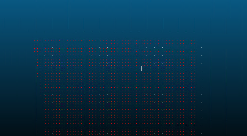

Here is a more obvious example of it. I've got the original 1 m grid selected (red points) and the 5 m grid generated by exporting the rasterised surface as a cloud (white points)
When I turn both point grids (1 m raw, 5 m ave raster from cloud compare) into ACAD the 1 m contours look like this: Shifting the surface -2.5 m in the X and Y axis makes it line up.
I understand the convetion may be for raster, but if we're exporting it as an X,Y,Z cloud then surely it needs to be adjusted so the points are in the center of the raster pixel?

Hum, the fact is that the raster grid is placed by default on the bottom-left corner (point). But it can actually span over the right and bottom corners because we use regular steps (and a grid will be filled even if only one point falls inside, even in a corner...).
At least it explains why you see the output grid cell 'centers' fall at half the step size compared to the initial points (because, especially on an initially gridded cloud, the points on the left will always be on the raster cells borders, and the center of these cells will be at exactly half the cell size on the right... The user can change the origin of the grid to avoid this problem.
I'm a little bit more surprised by the (grid) points on the right or on the top, that seems a little bit too far from the right border. I'll investigate on that.

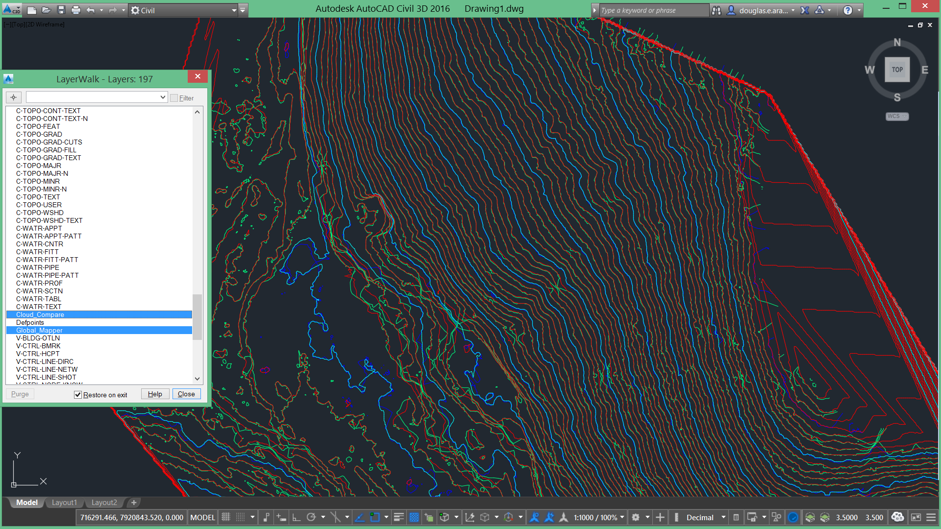

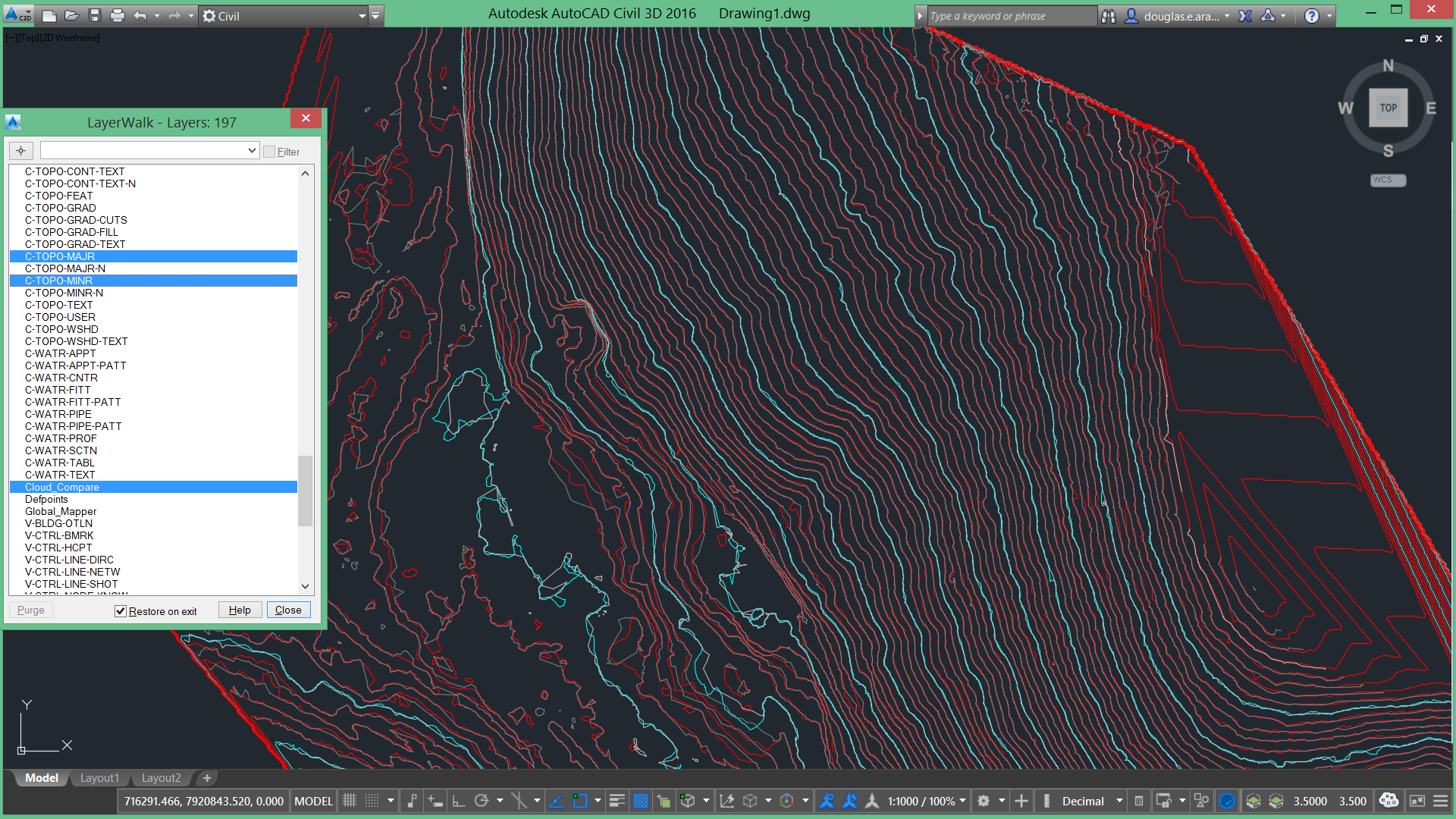

Great result. I made the test according to your observation (I moved in the southwest orientation) with 1m mesh (x = -0.5 y = -0.5) and made the comparison in 2 softwares - Global mapper and Autocad Civil 3D. See Below. The result was quite satisfactory considering the difference in the algaritm of software. Congratulations Andrew Perth for the help.
- Contorn lines CloudCompare_Red and Cyan e Autocad Civil 3D Gray.png (855.56 KiB) Viewed 11926 times
- Contorn lines CloudCompare_Red and Cyan e GlobalMapper Green and Blue.png (921.95 KiB) Viewed 11926 times
