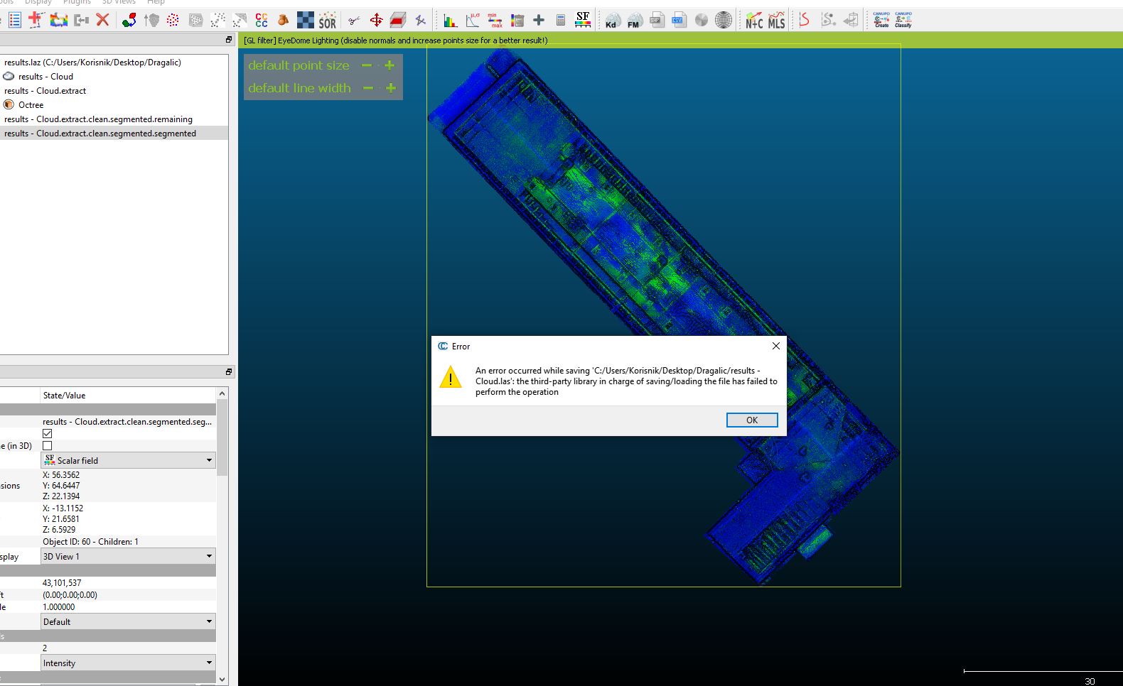

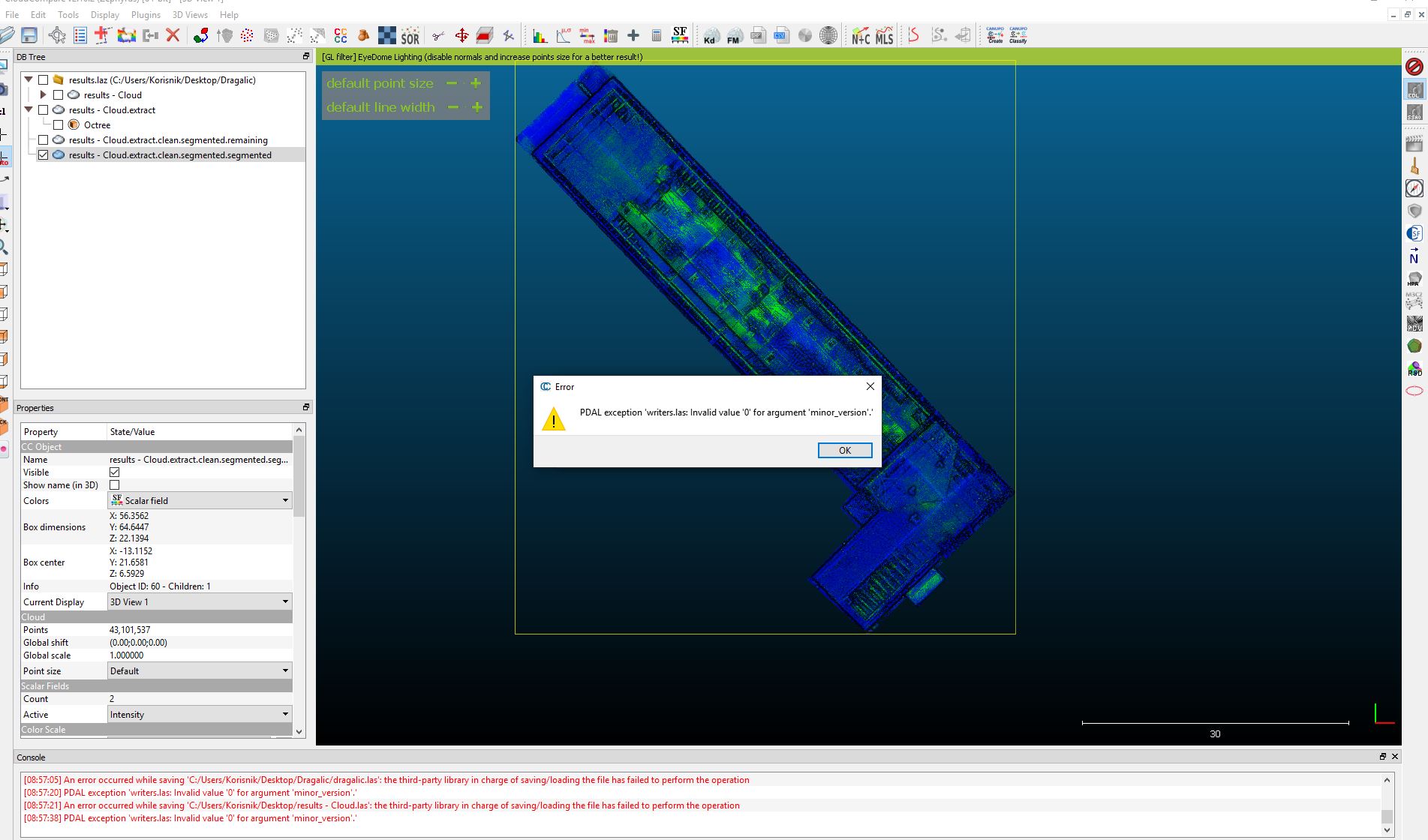

I'm trying to save file as LAS cloud (*.las*.laz) format but error keeps popping out it says "PDAL exception 'writers.las: Invalid value '0' for argument 'minor_version'." Can you tell me what I'm doing wrong?

This error is happening because the file you openned must be a LAS version 1.0.
When a LAS file is openned, CloudCompare remembers the minor_version (here '0') and saves the file with the same minor_version, however pdal does'nt seem to be able to save LAS files with version 1.0.
So when saving a LAS 1.0 we should bump the version of the saved file to 1.2, the most common version used.
