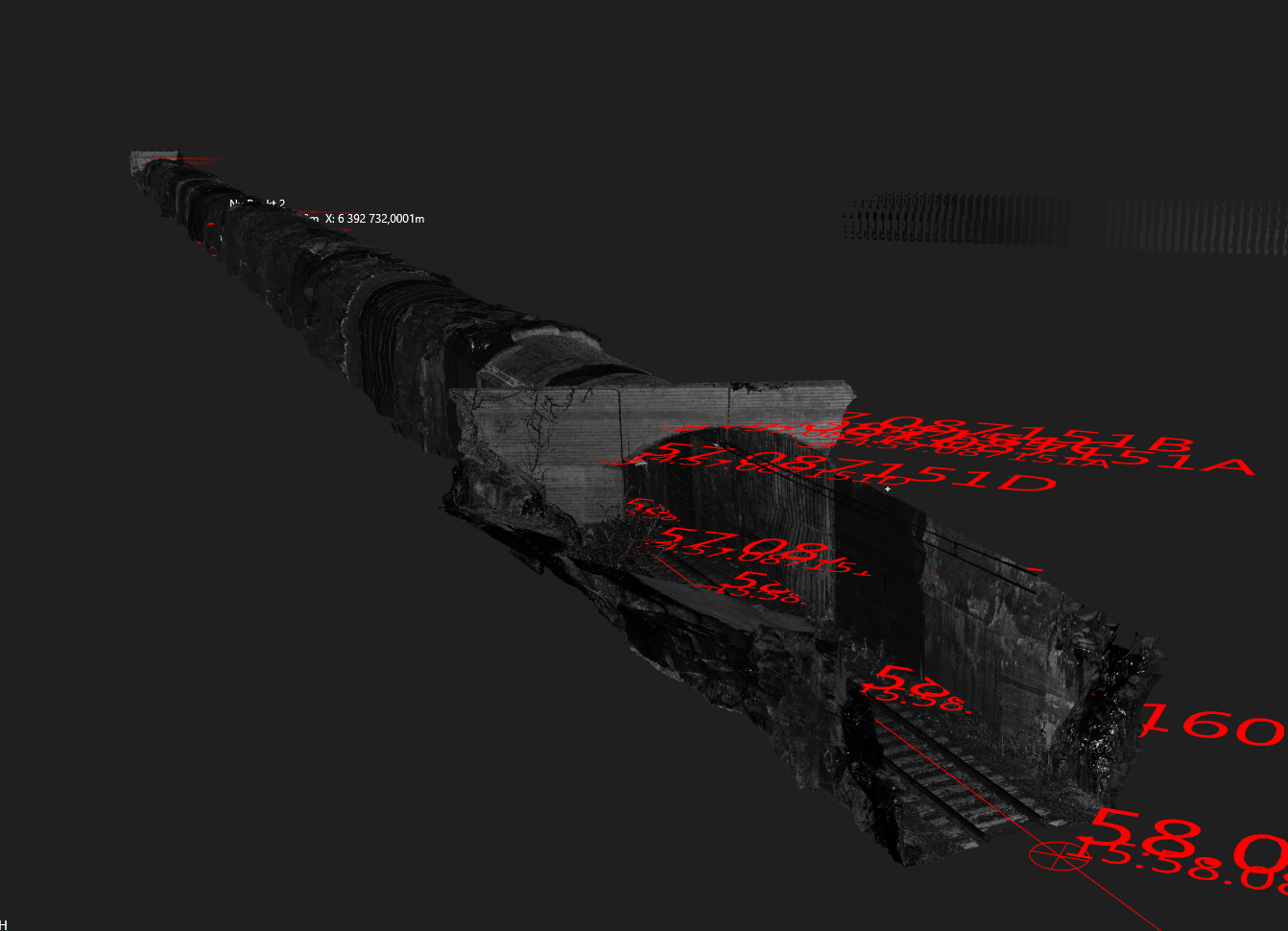

Hi, i have a very special issue that i havent seen before. In CC my pointcloud slices up and looks really weird, i have tried the same pointcloud inside of leica infinity and also i recap and it looks good with no problems at all. so im hoping that someone here has a good idea :)
PC1 shows how it looks in CC
PC2 shows how it looks in Leica Infinity
Thanks!:)

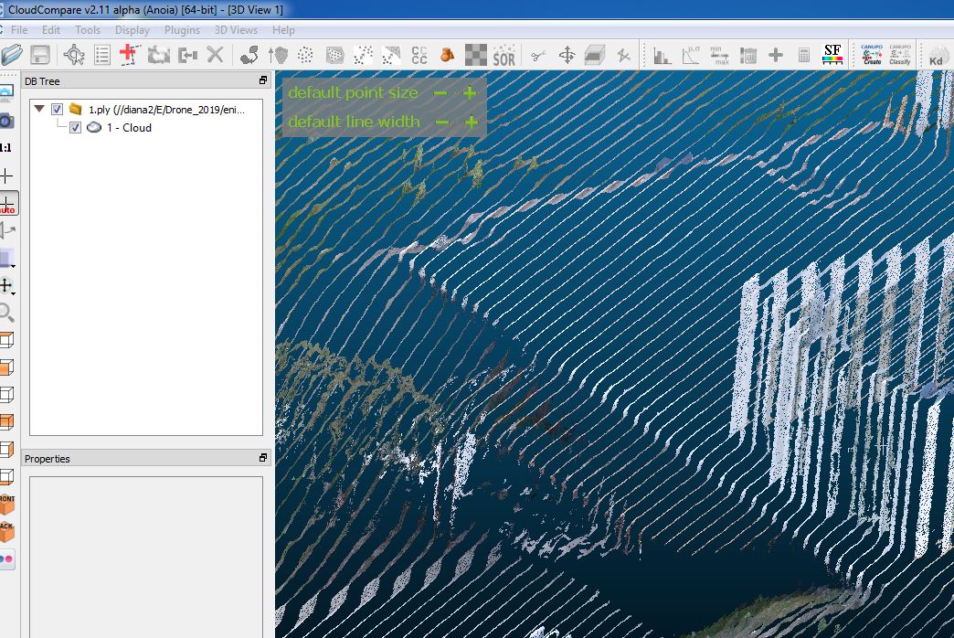

I'he the same problem ....Help, please

Same question: have you accepted the Global Shift as suggested by CloudCompare?!

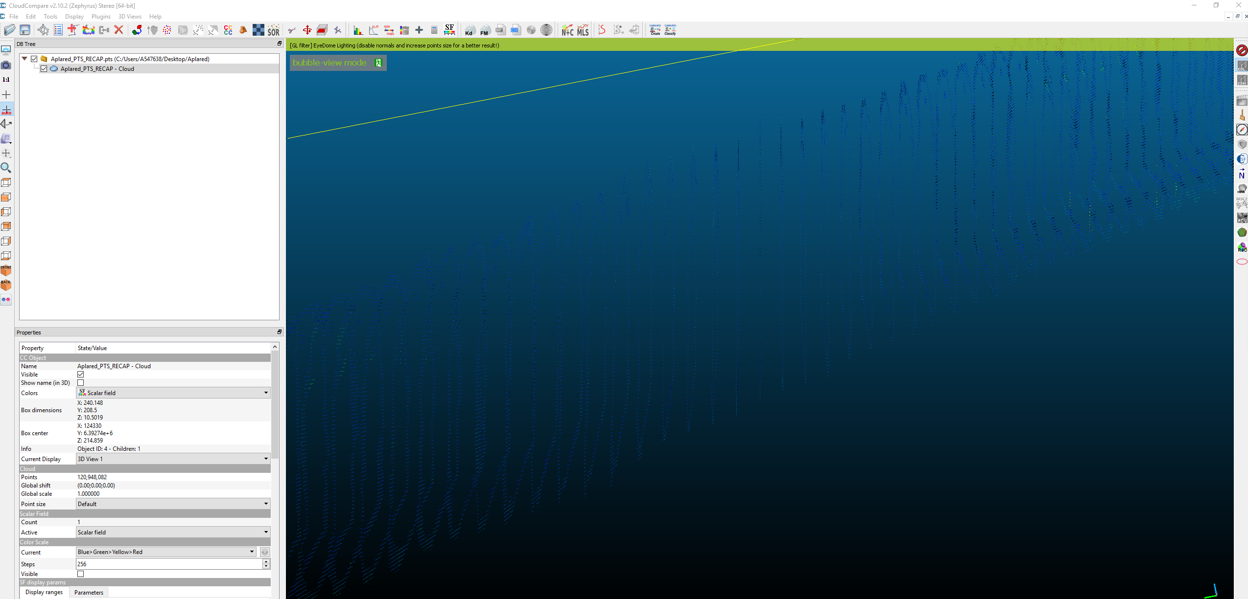

Note for future pepole who encounter this problem : just put -GLOBAL_SHIFT AUTO after the -O in your command
