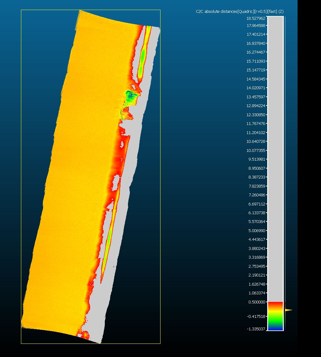

I have a couple of questions regarding the çloud-to-cloud distance option:
1. I read that the scale unit is the same as the origin file. So if the origin file is in m, then the displayed distances after the comparison are in m too, right?
2. The distances that I get when I split x,y and z are in which axis? How do I get the z from that?
3. I have two strip that don't overlap 100% and the largest difference appears where there is only one strip. Is that difference the result of: strip coordinates-0??? And if yes, where is zero considered?

2. each 'component' is output in a different scalar field. Simply select the 'z' one. And we use the main X, Y and Z vectors of the default coordinate system
3. the C2C distance is the 'distance to the nearest neighbor', therefore there's always a 'neighbor', even though it may be very far. If you want more clever/robust distances, you should consider the M3C2 plugin.

And also, I get negative distances, although I read under another question that C2C always returns positive distances. Is that right?
