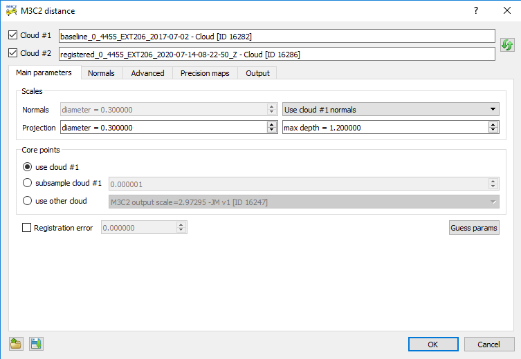

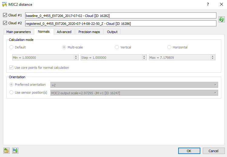

having difficulties around running M3C2 plugin via the command line interface. I am trying to run the following parameters (see attached) but functions as "false" are still being processed. Attempting to use M3C2 with;
- normals pre-calculated on Cloud#1 (no normals calculated)
- no subsampling
The issue is parameters that are selected as false are still being used. Normals are being calculated with a normal orientation, and it's still having a subsampling ratio applied. I can work around the subsampling ratio with a low number but I cannot resolve the incorrect normal orientations. All available normal orientations are incorrect and I use the sensor position usually to calculate this. When I use these parameters in the user interface it turns out as desired but not through the CLI. How do I resolve the normals orientation in the command line interface as my program requires doing it through this way?
Topic won't let me attached the parameters used so see below.

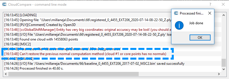

C:\>"\Program Files\CloudCompare\CloudCompare" -O \Users\%username%\Documents\66\baseline_0_4455_EXT206_2017-07-02.ply -O \Users\%username%\Documents\66\registered_0_4455_EXT206_2020-07-14-08-22-50_Z.ply -M3C2 \Users\%username%\Documents\66\m3c2_params.txt
baseline file has normals pre-calculated using Normals/Compute - LS PLANE - radius 0.3 - MST, knn=6
run in CLI with parameters for Normals for UseCloud1 & subsampling = false but still did normals calculation and subsampling
error in CLI "Can't restore the previous normal computation method (cloud#1 or core points has no normals)"

Image attached shows error message in command line. Originally was trying this using v2.10.2 before updating to v2.11.3 and seeing no difference.
