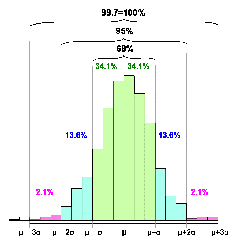

I was wondering how I could get a percentage of a C2C result in addition to the scale bar.
I mean, in the scale bar we can have a idea of the amount of pts below a given value... but If I want to know exactly what is the percentage of pts below a threshold (or why not asking : what is the value in the scale bar where 68% is meet ?).
something similar to QUANTILE https://fr.wikipedia.org/wiki/Quantile
thanks
