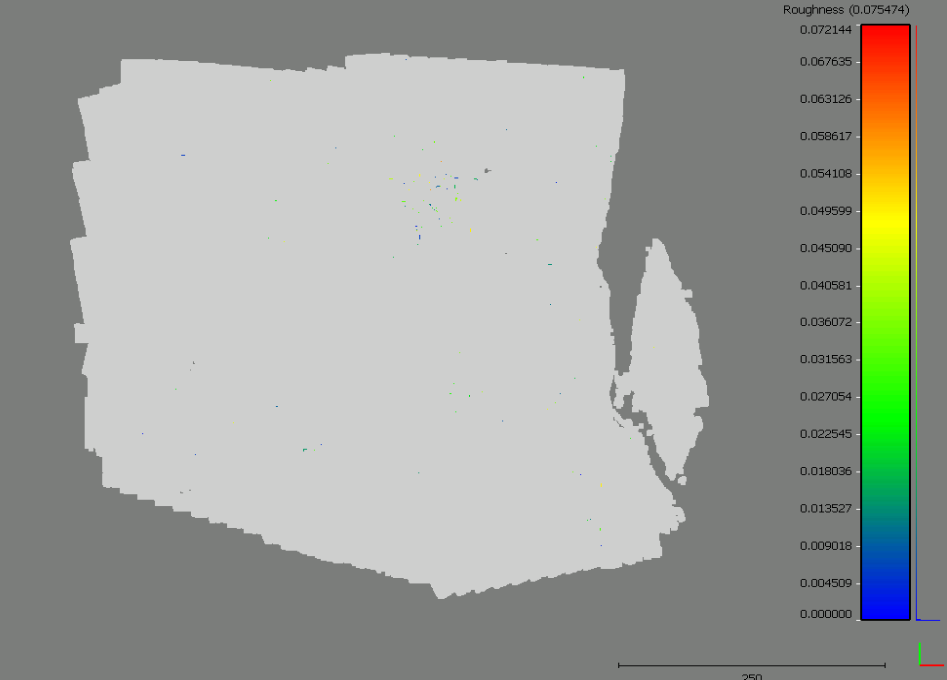

2) In the Lague paper it is mentioned that I should set the Normal scale (D) to a value that is at least 25x roughness of the point cloud. The figure below depicts the roughness I calculated on cloud#1. While the overview depicts nothing but grey values (no roughness?!), a zoom in reveals values mostly ranging between 0.02 and 0.3, which would call for a Normals value of 0.5 to 0.75. When I use "guess parameters" the program however repeatedly gives an output of 1.17 normals diameter and 0.59 projection diameter.

A) Regarding your second point (2), it's obvious that the radius you used to compute the roughness it way too small (grey color means that there was not enough points around each point to compute the roughness). You have to compute the roughness on a bigger radius (until almost all points have a roughness value).
