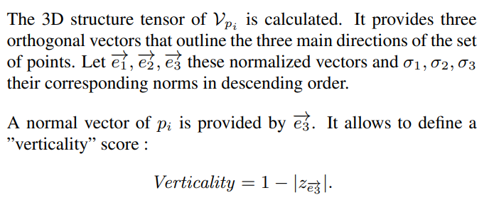

I found a bit more info in the paper "STREAMED VERTICAL RECTANGLE DETECTION IN TERRESTRIAL LASER SCANS
FOR FACADE DATABASE PRODUCTION":
But I still don't understand exactly how to create the tensor, can anyone tell me how to create it from the coordinates of the points that make up the neighbourhood?
Re: Calculation of verticality
By 'tensor', they actually refer to the 'cross correlation matrix'. And e1, e2 and e3 are the eigenvectors of the this matrix, while sigma 1, 2 and 3 are the associated eigenvalues. e3 is the eigen vector associated to the smallest eigenvalue.
