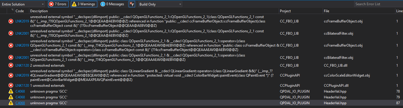

Since it appeared that the build was still searching for qLASFWFIO, I set -DPLUGIN_IO_QLAS_FWF=OFF and got a successful cmake. But building in Visual Studio 2019 resulted in 7 errors:
Screenshot 2022-10-24 112217.png (63.74 KiB) Viewed 8504 times

-- Up-to-date: C:/Program Files (x86)/LAStools/include/LASlib/laszip_decompress_selective_v3.hpp
-- Up-to-date: C:/Program Files (x86)/LAStools/include/LASlib/laszipper.hpp
-- Up-to-date: C:/Program Files (x86)/LAStools/include/LASlib/mydefs.hpp
-- Up-to-date: C:/Program Files (x86)/LAStools/lib/LASlib/Debug
-- Up-to-date: C:/Program Files (x86)/LAStools/lib/LASlib/Debug/LASlib.lib
-- Up-to-date: C:/Program Files (x86)/LAStools/lib/LASlib/Debug/LASlib.pdb
-- Up-to-date: C:/Program Files (x86)/LAStools/lib/LASlib/Release
-- Up-to-date: C:/Program Files (x86)/LAStools/lib/LASlib/Release/LASlib.lib
-- Up-to-date: C:/Program Files (x86)/LAStools/lib/LASlib/Release/LASlib.pdb
CMake Error at LASlib/src/cmake_install.cmake:122 (file):
  file INSTALL cannot find
  "D:/CloudCompare/LAStools-master/LASlib/src/../lib/MinSizeRel": No such
  file or directory.
Call Stack (most recent call first):
  cmake_install.cmake:37 (include)
I gather MinSizeRel is related to the Debug or Release installation type, but that is honestly over my head. I've tried building in Visual Studio separately with the Release configuration (since build in VS code seems to default to Debug). Both configurations result in the same CMake error.
Thanks in advance for any insight!
Paul
Re: Issue making CC with LAS plugin
Where did you find this version of LASTools?
I don't have the same structure on my side (I got mine from github, and I compile it with an upgraded/converted version of the Visual Studio solution:
https://github.com/LAStools/LAStools/bl ... LASlib.dsw
pflani
Posts: 7
Joined: Tue Aug 24, 2021 4:22 pm
Post by pflani »
Daniel,
I found a workaround.
I will keep that version of LASTools in my notes to try if/when the workaround stops working!
Thanks as always for your time!
Paul
