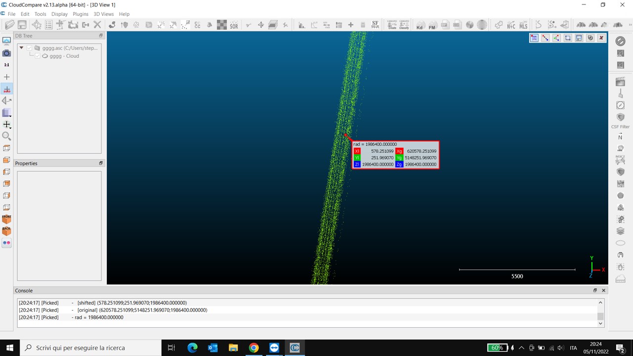

I am importing a txt file with X, Y, Z and Scalar field values. The coordinates are projected (so in meters) and I correctly apply the shift to have a similar scale. Unfortunately the point cloud still remains like a line of points (the typical error when you import geographic coordinates). By clicking the info of a random point I can say that the Z coordinate is not read but it's associated to the scalar field (that has big numbers). I wonder how it is possible to specify the right column for the Z coordinates or if there are other solutions to import this cloud.

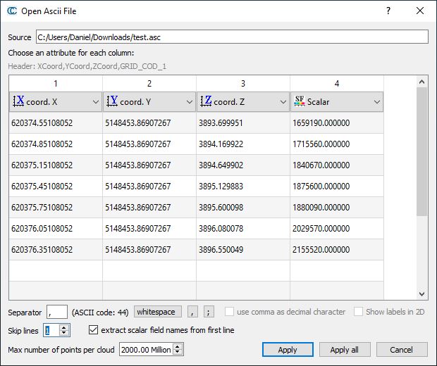

In the 'ASCII file' loading dialog, you can check and change the role of each column.
But on my side the roles are properly assigned (with the 2.13.alpha version at least):

thank you for your interest. I gave a try also on the 2.13 but the result is the same: a correct importation (like the screenshot you showed) but a wrong cloud generation. If you pick the information of a single point the weird thing is that the scalar value is duplicated both on the scalar field and Z (see attachment)...
