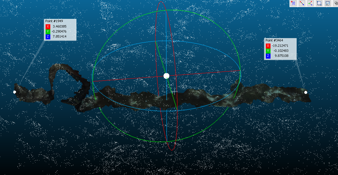

Basiquely, I want to know the mean slope between this two point of my models
- point and slope
- Capture d’écran (11).png (189.72 KiB) Viewed 11344 times

In CloudCompare, there's basically two ways of computing the 'slope' (as the 'dip' and 'dip direction' values):
- either you fit a plane on a subset of points (at least 3, but in your case you can try to fit a plane on your whole cloud). You'll get the corresponding plane normal and also the equivalent dip and dip directions (either in the Console or in the plane properties dialog).
- otherwise if you have normal vectors expressed for each point of your cloud, you can convert them to 'dip and dip direction' values (Edit > Normals > Convert to > Dip / dip direction SF). If you don't have the normals, you can compute them with 'Edit > Normals > Compute' (see http://www.cloudcompare.org/doc/wiki/in ... %5CCompute). But to get the slope between your two extreme points, you would have to use a huge radius, and it would be a bit overkill. I think the plane fitting option should work better.

Thank you daniel
The plane fitting option is easier and it work perfectly...
But I'm just asking how it work.
Witch point i use for determinate the slope orientation ( dip direction)
Re: Measure Slope
Well, the plane fitting option uses all the points. You can segment the cloud (with the scissors tool) if you want to be more selective.
