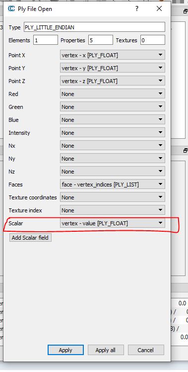

You're using the `--density` flag correctly. When you do so it adds a vertex attribute named `value`. Just make sure you select that attribute as a scalar field, see below, when you import the resulting ply in to CloudCompare.

jedfrechette wrote: Fri Oct 30, 2020 11:41 pm You're using the `--density` flag correctly. When you do so it adds a vertex attribute named `value`. Just make sure you select that attribute as a scalar field, see below, when you import the resulting ply in to CloudCompare.
Is it possible to Load the Mesh(PLY File) via CLI specifying Scalar field with vertex-Value??
As mentioned above i am able to load the Mesh File by specifying the Scalar field as shown using UI but i am unable to implement it via CLI, kindly help.
