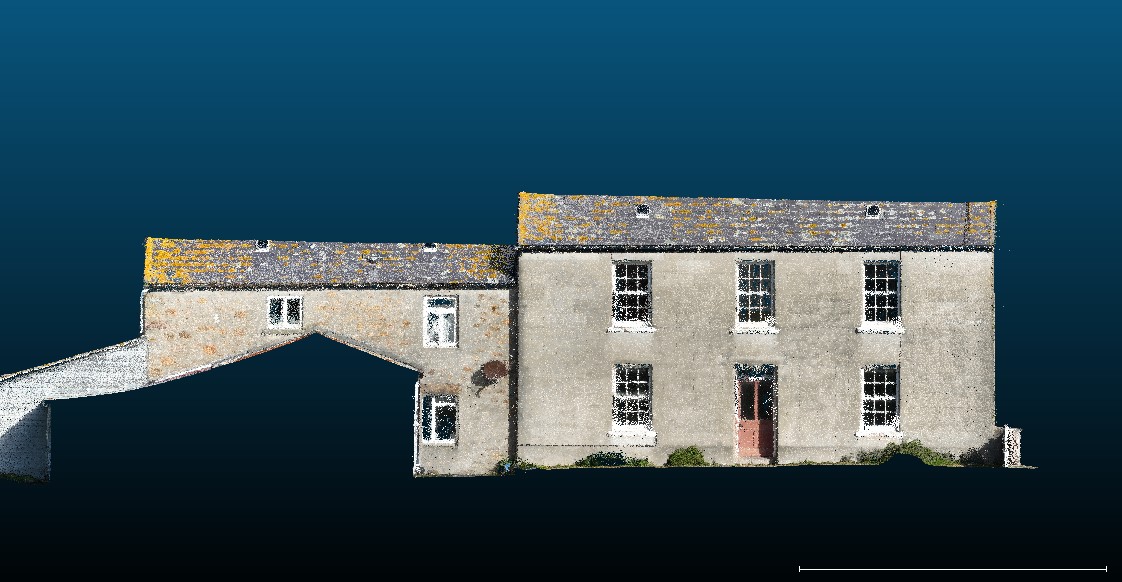

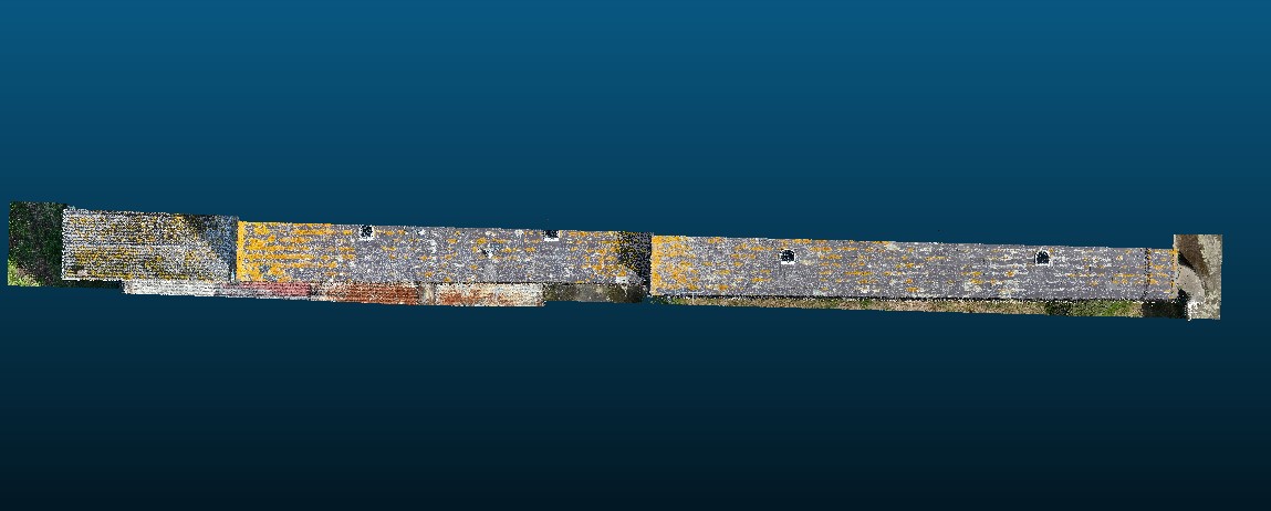

Could some one help. I have a point cloud of a building and would like to rasterize the front elevation to geo.tiff. I have created the cross section of the front elevation, but when I try and rasterize it, all I get is a top down view and I cant get an elevation view.
I have attached a view of the front elevation I would like and the view I am getting.
Raster view I am getting
Screenshot 2023-08-03 145455.jpg (71.01 KiB) Viewed 3278 times
Raster view I would like
Screenshot 2023-08-03 145318.jpg (135.24 KiB) Viewed 3278 times

Sorry for the late reply, I was in vacations.
You probably have to change the 'projection' direction in the Rasterize tool parameters.
