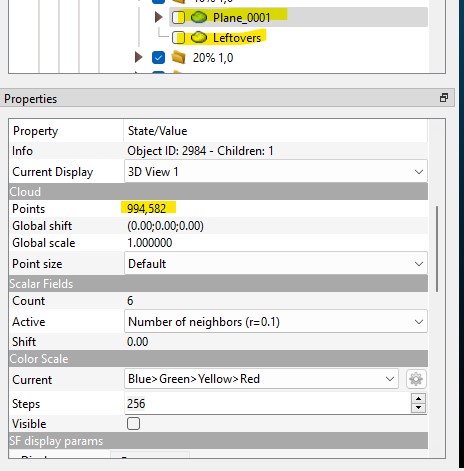

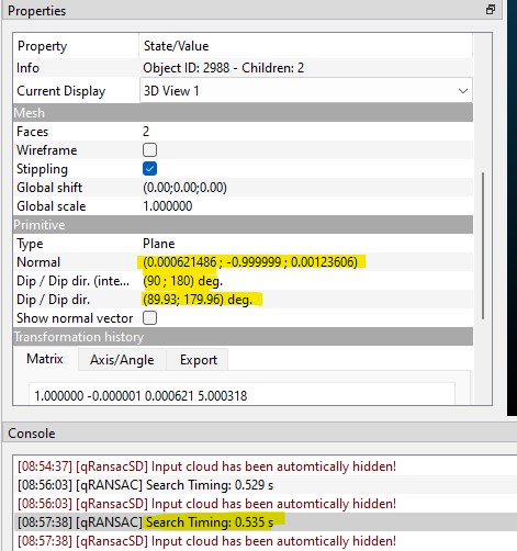

after unsing the RANSAC, we will get a plane primitive specific information such as Normal, Dip / Dip direction, the search time in the console, as well as the points of the plane and the leftover. Is there a way to export these information to a file.
Thanks in advance
Andreas
Points Plane Leftover.jpg (48.92 KiB) Viewed 2313 times
Posts: 8183
Re: Export Information
Hum, not easily...
Maybe it would be easier via the command line option (but I've never used the -RANSAC option myself: https://www.cloudcompare.org/doc/wiki/i ... _line_mode).
Or maybe via CloudCompy?
