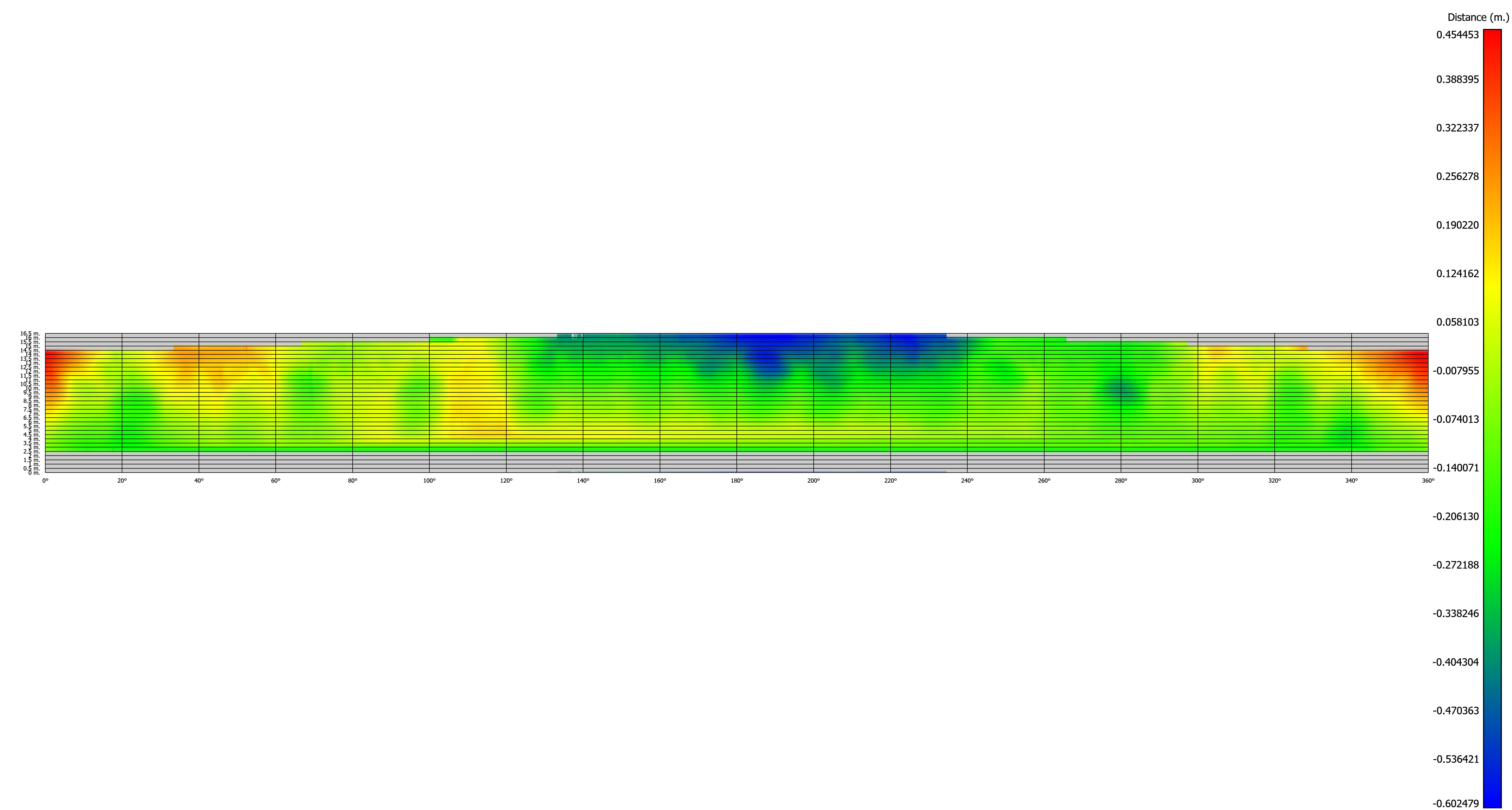

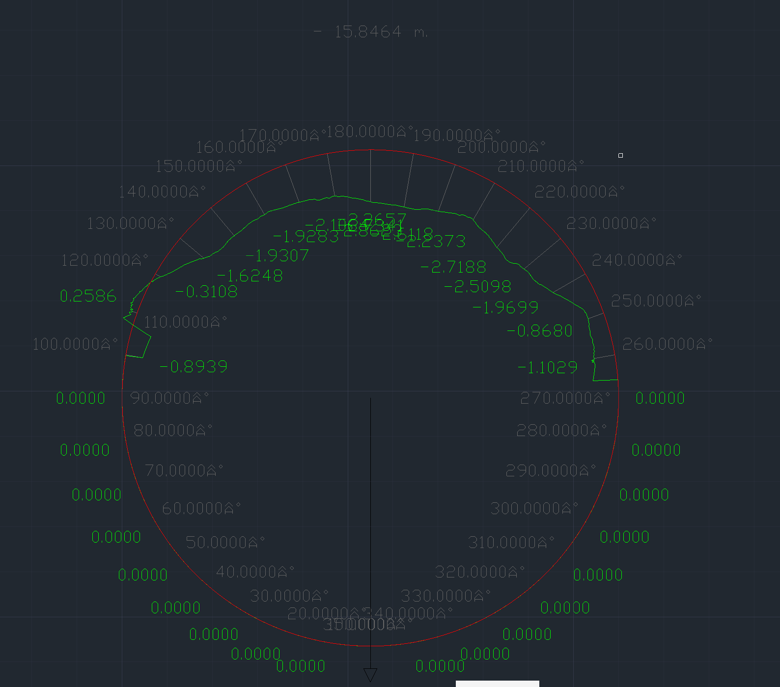

Hi, I'm trying to do deformation analysis of a tank, I imported a pts point cloud, created a theoretical cylinder. The 2D map shows maximum values of 0.45m but in the generated dxf files the values go up to -2.71m for example. I set the drawing magnification when generating the dxf to 10. I tried different ways and each time the values are similar. Why is there such a discrepancy between the dxf files and the generated map and scale. I attach a 2D map photo and a screen shot of dxf
- screenshot.png (60.15 KiB) Viewed 14983 times
- mapa.jpg (1.55 MiB) Viewed 14983 times

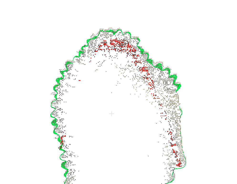

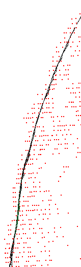

I've coded something, however the cubic, quadriatic and polynomial curve (red) don't follow the object's shape. It's supposed to fit similarly like the green line. Do you maybe have an idea how to approach this?
- curve-fit.png (56.42 KiB) Viewed 14714 times
Re: tank analysis with ransac problem
Have you tested the 'contour extraction' tool? https://www.cloudcompare.org/doc/wiki/i ... ngle_slice
If properly parametrized, it can extract the 'concave' hull of a point cloud.
