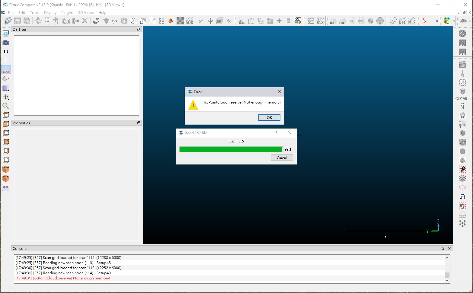

Is there any possible way to import the 62GB e57 in cc?
螢幕擷取畫面 2024-04-05 175041.jpg (163.06 KiB) Viewed 7321 times

Well, it all depends on the memory your PC have. As long as the individual scans don't contain more than 1.5billion points each, CloudCompare can normally handle them.
