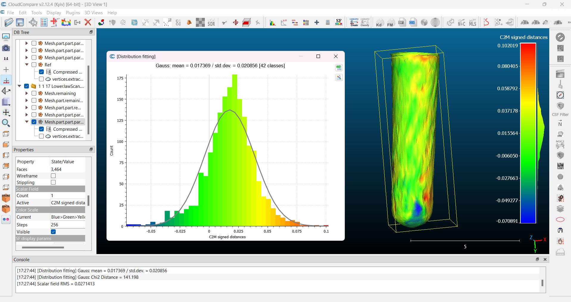

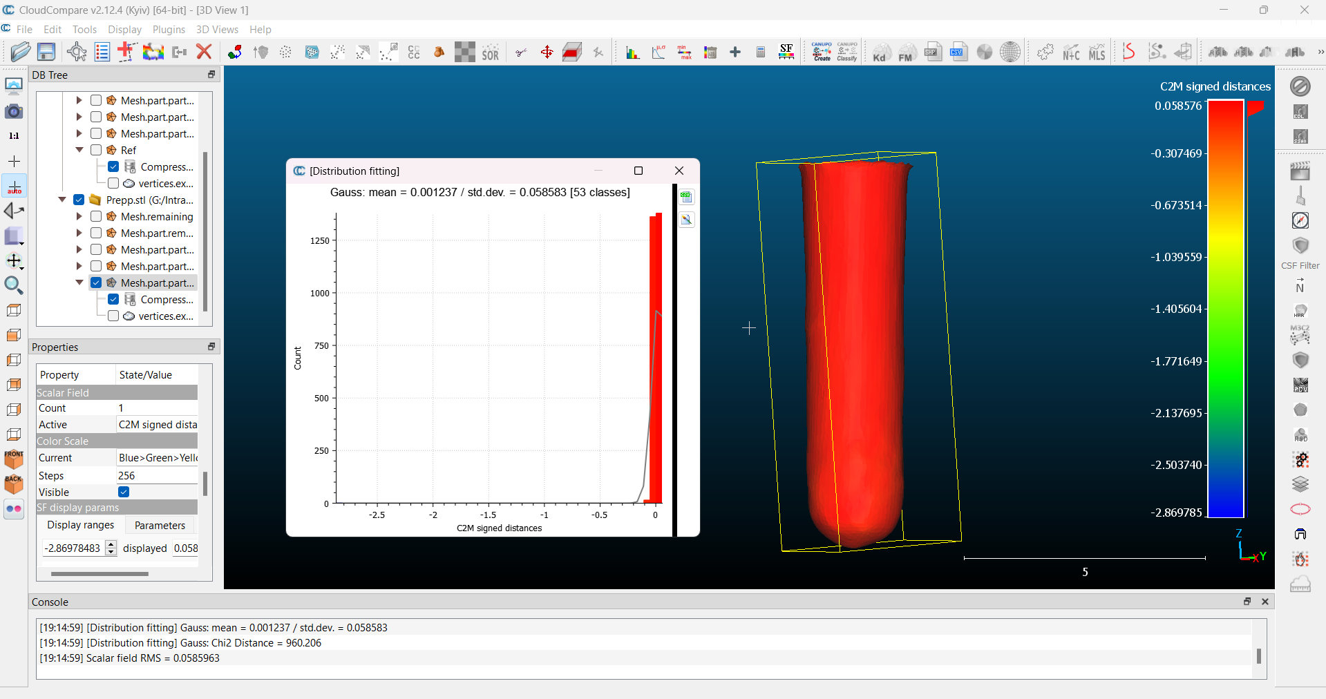

I am currently engaged in my research, where I have segmented two files for superimposition. However, upon selecting these segmented files for the C2M process, I have encountered a recurring issue, the source of which remains unknown to me ( Photos 1 AND 2)

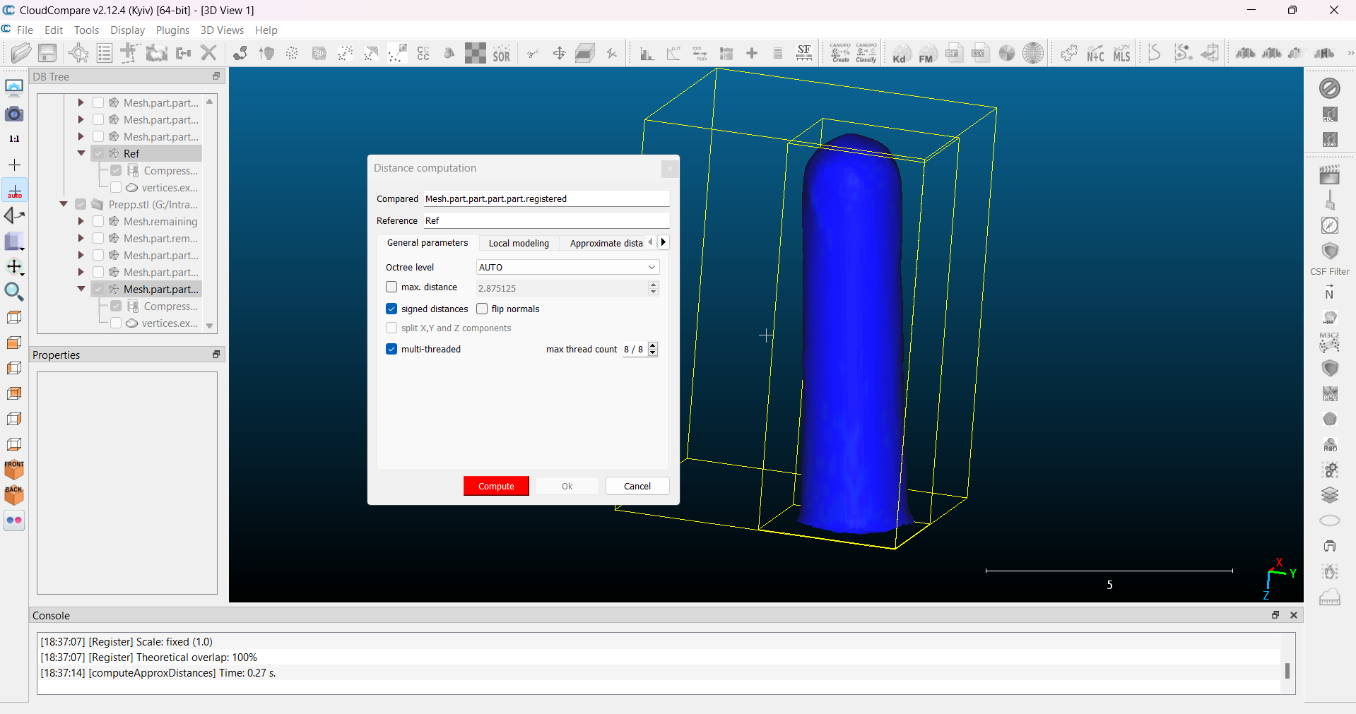

Interestingly, I have executed identical steps with other samples without encountering this problem (photo 3). (I have ensured proper selection of both the reference and control files.)
Posts: 8183
Re: displaying a single color on the scaler field
It is not clear to me what the problem is exactly, but I would guess that there's one point that has a totally different distance from the rest.
This make me thing about a 'limitation' of the C2M that was fixed recently in version 2.13.1 version. Can you test with this new version and report here if this fixes your issue or not?

I had to remove some points that were distant from the model, but after doing so, it worked.
