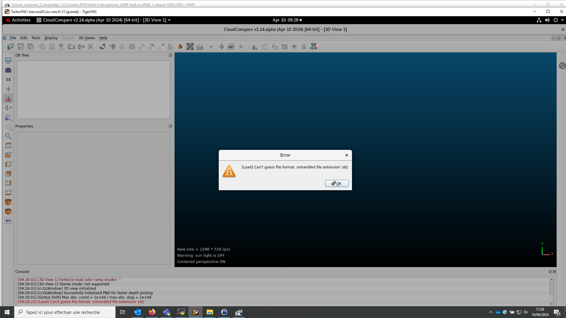

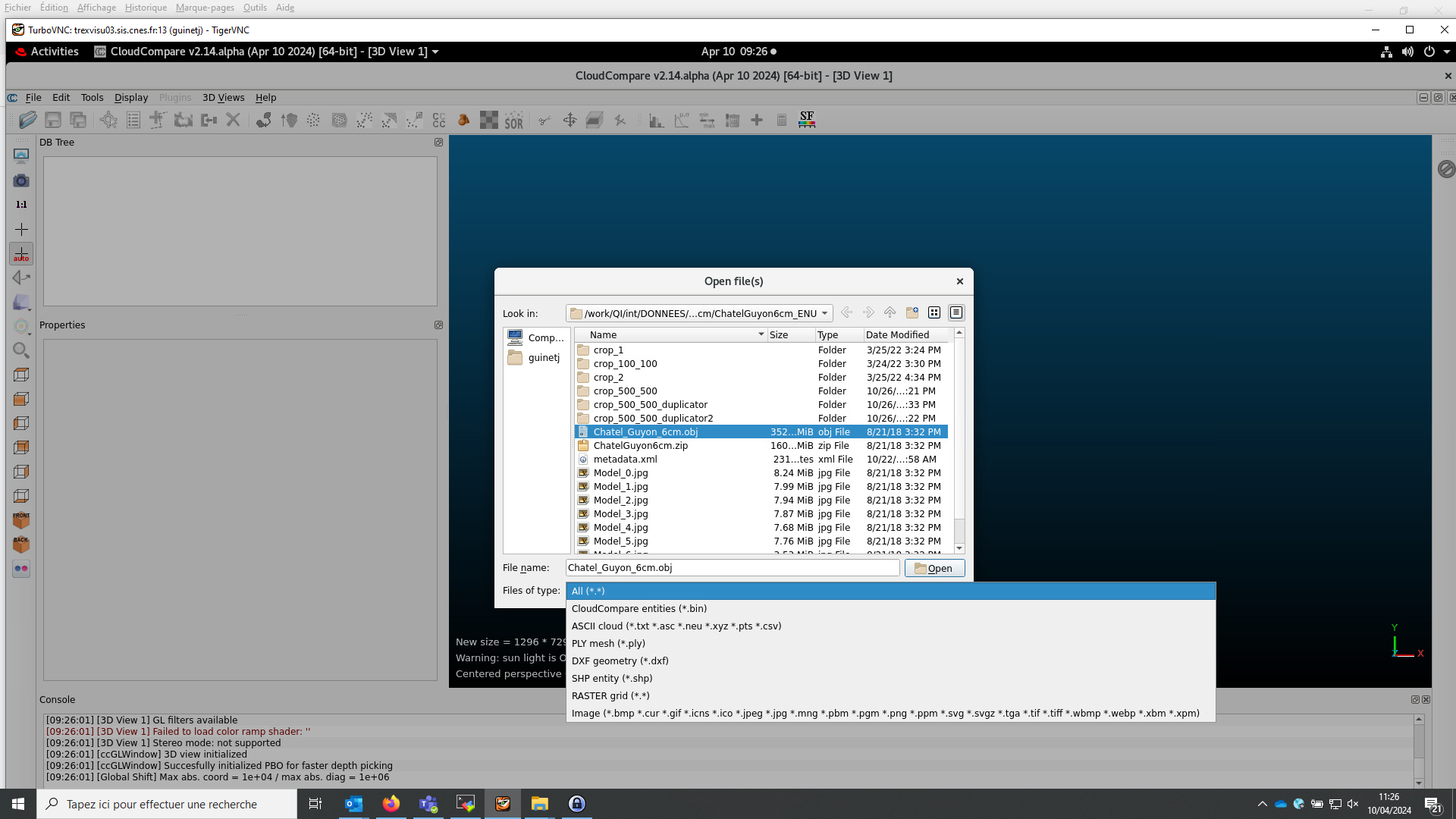

I have compiled and installed CC on liunx arch with Cmake (using master version), but i can't open OBJ files (my OBJ are OK I had tried in the past with an older cloudcompare version), please see the attached pictures.
I have tried to check some CMake IO option without results.
Do you know if there is compilation option for this file

You have to enable the QCORE_IO_PLUGIN project (CMake option PLUGIN_IO_QCORE).

Thanks for your answer daniel, it seems to have no effect on results.
QCORE_IO_PLUGIN seems to be correctly compiled :

but i have not found any link to this libQCORE_IO_PLUGIN.so in CloudCompare bin

Have you proprely 'INSTALLED' the solution? (make install)

Yes with user INSTALL_PREFIX (i have not root permission on this machine)
