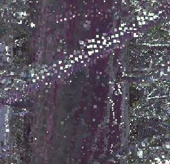

I am a semi new user to cloud compare and am working on a 3d scan of a forest for my final thesis. Currently, I am finding different views to render to showcase parts of my project. As I look into it more I notice that the individual points are registering as square/cubes; is there a way to have them register/show as spheres or circles?
Square Points.JPG (36.79 KiB) Viewed 3546 times
Re: Points registering as square, not spheres
If you use quite recent versions of CloudCompare, you have an option to show the points as circle in the 'Display > Display settings' dialog.
