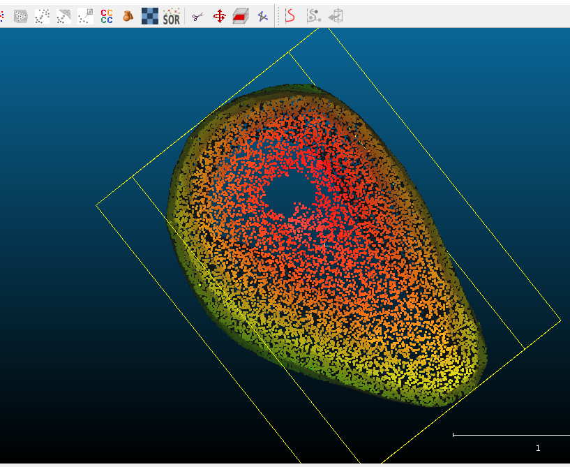

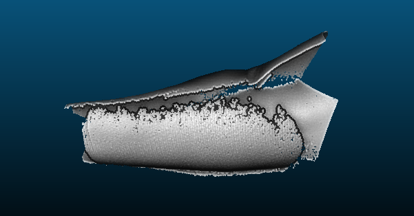

Hey guys,
Guys, I have this point cloud (see image 1) with these holes and I want to create a mesh of it.
So when I create a mesh, cloudcompare fills these holes automatically(see image 2) and I don't want that, and I wanted to know if anyone here knows how to solve this problem.
Thank you.

I guess you should activate the 'Density' output?
See https://www.cloudcompare.org/doc/wiki/i ... n_(plugin), last section.

If you can not manage by using "Density' output", You can use segment tools to open a hole in the mesh.
Also, You can edit in Blender 3D software
