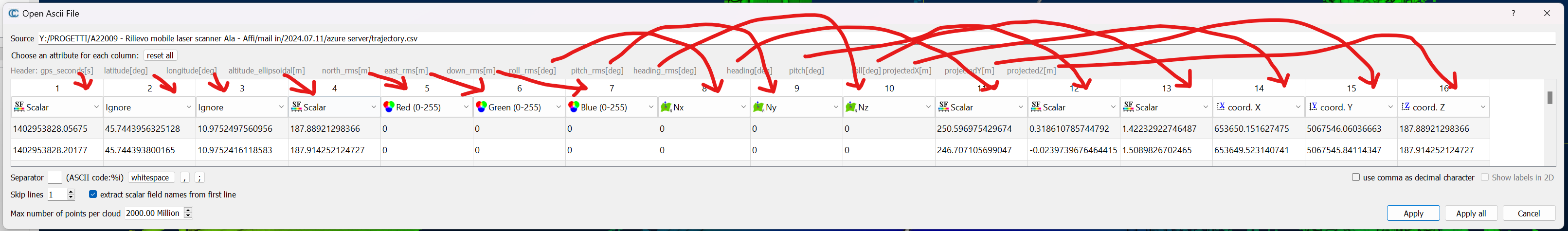

I have a suggestion for improving CloudCompare that I believe would be very beneficial. When importing ASCII files that have scalar names in the first row, it would be incredibly helpful if, when the option to use the first row as the scalar names is activated, CloudCompare could also parse the first row and display the column names in the import data table. This way, it would be much clearer which column represents which value, just as shown in the image I'll attach.
This small enhancement would make the import process much more intuitive and user-friendly.

Adding that to the TODO list.
