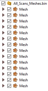

Concerning the import of multiple meshes
I have a folder with multiple meshes (.ply files) and use a command line script to regroup them into one single .bin file. The .ply files have all different names, but once regrouped into a single .bin file, all meshes are simply called "Mesh" with no other way to distinguish them in the DB Tree.
Is it possible to import the meshes while keeping the filenames referenced?

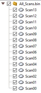

Concerning the export of multiple .asc files
I use the command line to open a .bin file with multiple clouds and export them one by one as .asc files.
The original .bin file has following DB Tree structure
To export the files, I provide filenames, creating a list of names.

This successfully creates following files
If no filenames are provided, the export does not reference the individual cloud name, but only the .bin filename followed by the numerical suffix.
Is it possible, instead of having to create an exhaustive list of names, to have the name of the specific cloud (eg. Scan13) used as name for the exported file?

Ok, so the fact is that things are currently fairly simple as they are generic and have to work for all formats:
- when a file is opened, a group with the filename is created, and all entities found inside the file (there can be one of a single type, but there can a lot of entities of different types) will all be created inside this group (with 'type' as base name, plus an index if there are multiple of them). Some formats store a name for each entity, in which case we will try to use it
- the command-line tool lods one or several files, and stores all the entities in 2 buckets (clouds or meshes). The original filename is stored for each entity, but it's not used to name the entity. It's currently used by the AUTO_SAVE command when no custom name is provided. I guess you could add a CLI option to transfer the base filename to the entities (if any).
- and batch-saving multiple files at once is almost never supported, apart for the ASCII format (because someone implemented it specifically). This can also be implemented for some other formats, but sadly this is something that has to be done for each individual format (as CC shows only the formats that can support and save the current selection of entities). Else we would have to change things quite a bit, or have a dedicated saving option, to make it a more generic behavior.

I have only now had time to look at it again, and found a way to rename the meshes which works for me.
Since it will use the "type" as base name once opened, it's possible to, immediately after opening the file, select the opened file with a regex pattern (the base name) and then renaming it with the -RENAME_ENTITIES command and the Filename.
As an example I used this code :
