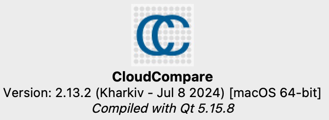

I'm running CC 2.13.2 on a MacBook with Apple Silicon M1. Attachment 0 is a screenshot with more exact info on my build.

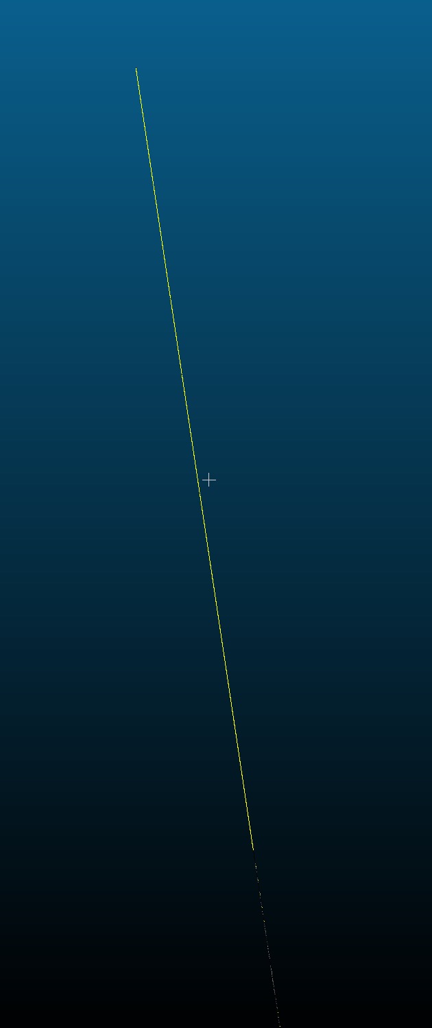

The .laz files from USGS load beautifully into CC but the files from NOAA result in the "Thin Line of Death" (Attachment 1).

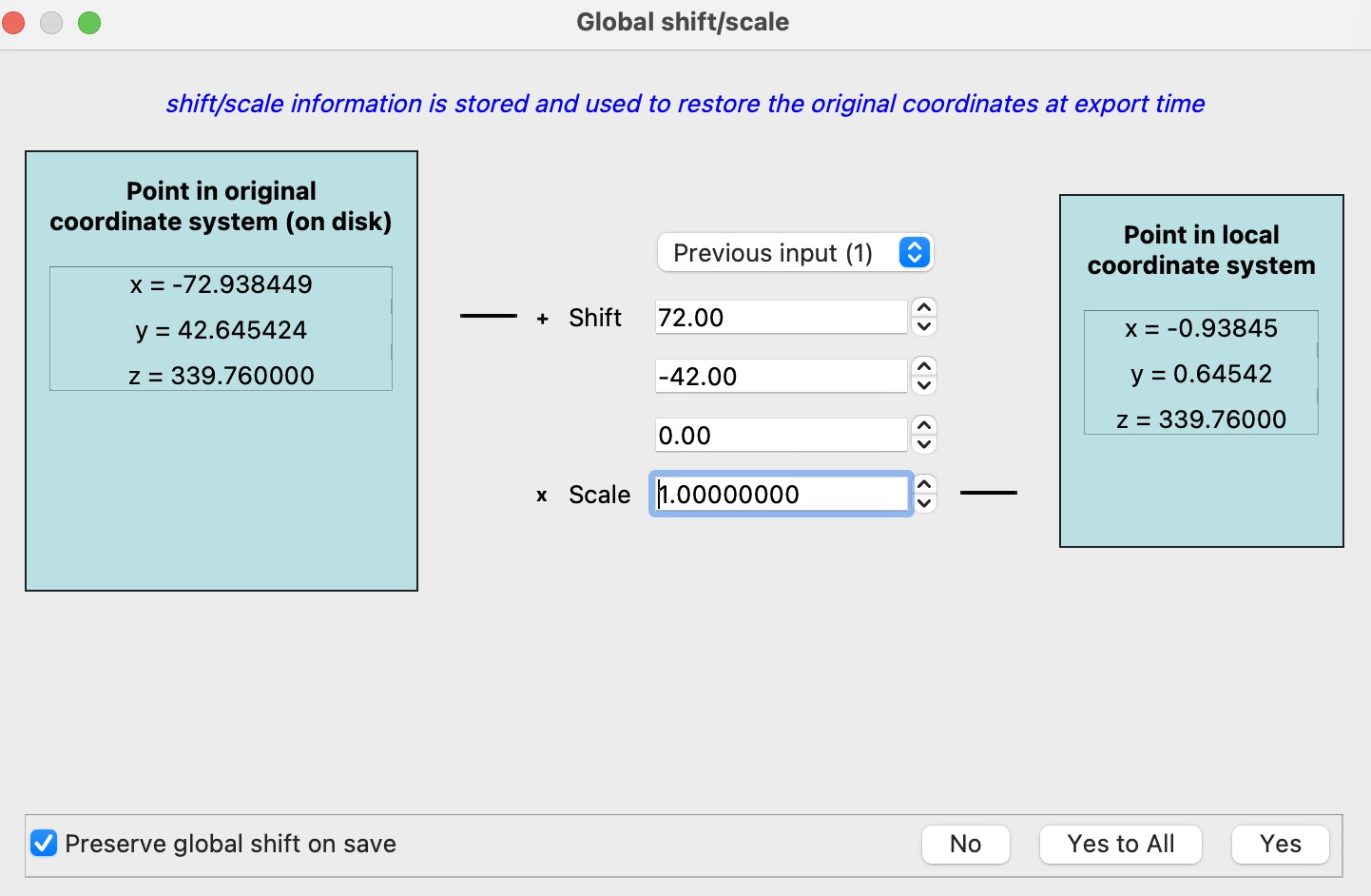

There are multiple threads about this issue from others, and it seems from reading other threads that the NOAA files are doing this because of their spherical coordinates when CC wants cartesian coordinates. In Attachment 2 it looks to me like the X and Y are in degrees and Z is a length, which probably confirms the source of the problem.

Re: The "Thin LiDAR Line of DEATH!!!"
It's probably because the coordinate system is not a Cartesian one. It's probably a geographic CS with X and Y being angles while Z is metric and has a very different scale.
I guess you can use GDAL to convert the points from one coordinate system to the other? (or any GIS).
