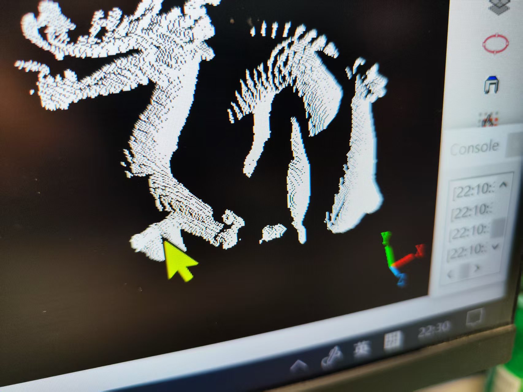

I installed cloudcompare 2.14.alpha, and at first it didn't show the scale and the center of coordinates, but after a while it showed itself, and I didn't even know how to turn it off.Today I installed the same version on another computer, but I can't find out how to display the scale and coordinate origin anyway, I don't know why.

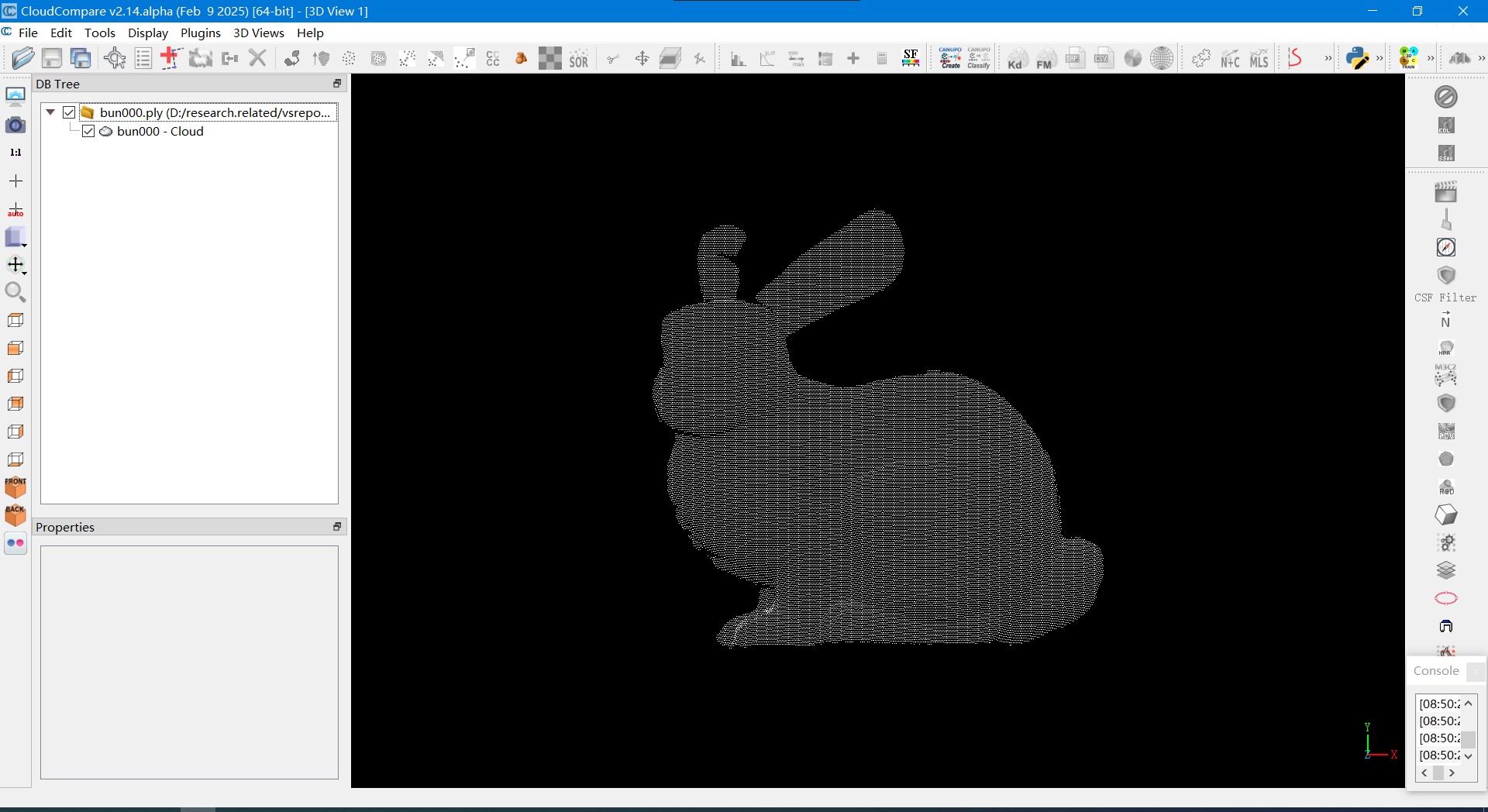

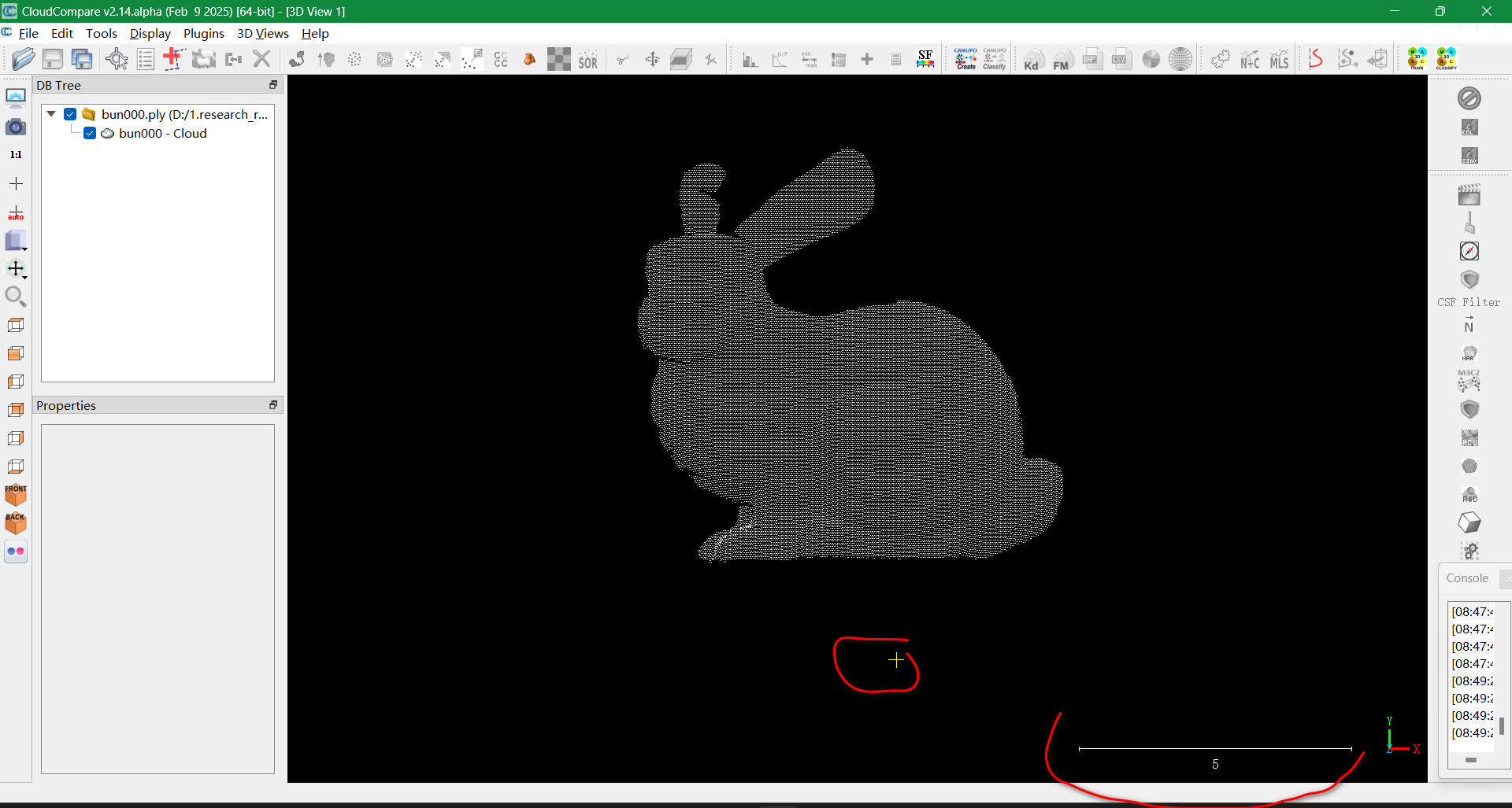

Re: how to display the scale and the center of coordinates,
Don't you see the scale in the second screenshot? Or are you referring to something else?

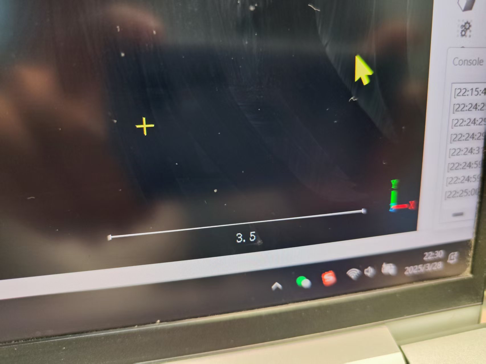

The two uploaded images are exactly what I mean, the first image don't display the center and the scale, and the second one has shown. The twomages corespond to the above laptop and computer I mentioned, I don't know how to display on another computer, I tried what you said, but it didn't work. so the problem is I can't display them on another newly installed cmoputer.

this is the first capture
So mind that the yellow cross is not the coordinate system or the screen center, it's simply the 'custom light position' (F7 to toggle it).
Are all the colors and materials are at their default? Can you try to reset them? (in the Display properties). The background is not supposed to be pure black either.
