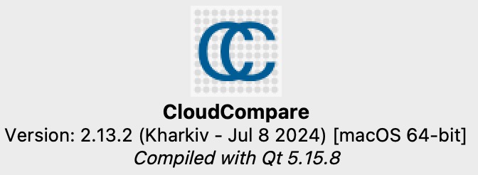

Here's the environment I'm running on a MacBook with Apple M1 silicon running Sequoia 15.3.1.

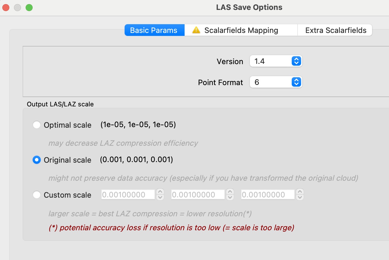

THE PROBLEM: I am unable to save ANY file from CC.
Here is the error message I get in the log window:
[16:29:11] An error occurred while saving '/Users/KenJacobMacbook/QGIS/LiDAR/temp test folder/USGS_LPC_CT_Statewide_C16_830905_nw_lasheight.laz': the third-party library in charge of saving/loading the file has failed to perform the operation
This error occurs if all I do is open a .laz file from the USGS website, do nothing to it, and then try to save it to a new file. And it happens to ALL other point clouds I've processed in CC (wonderfully, by the way -- very happy with what I can do in this program.)

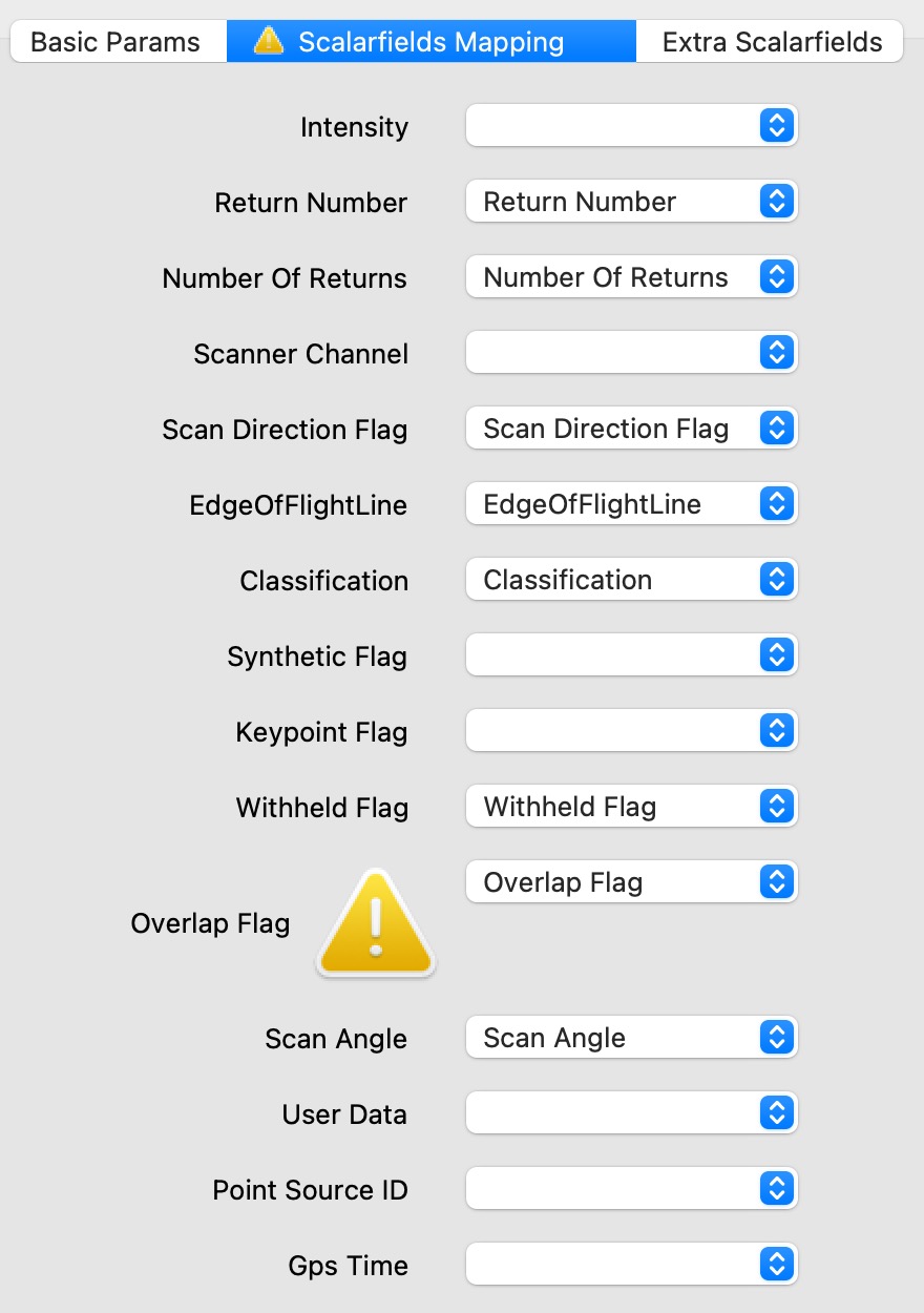

I've attached the state of the save dialog box (I didn't change anything) in case that's helpful.

I'm also concerned that the 2.13 version is getting quite old. We should ask Paul Rascle to create a new binary with the latest 2.14.alpha version...

Isn't it different from the initial message? Because at that time the LAS saving dialog was visible...
Anyway, macOS is a different world. So maybe now that you have compiled the project there (good job by the way), you can debug things a little bit?
