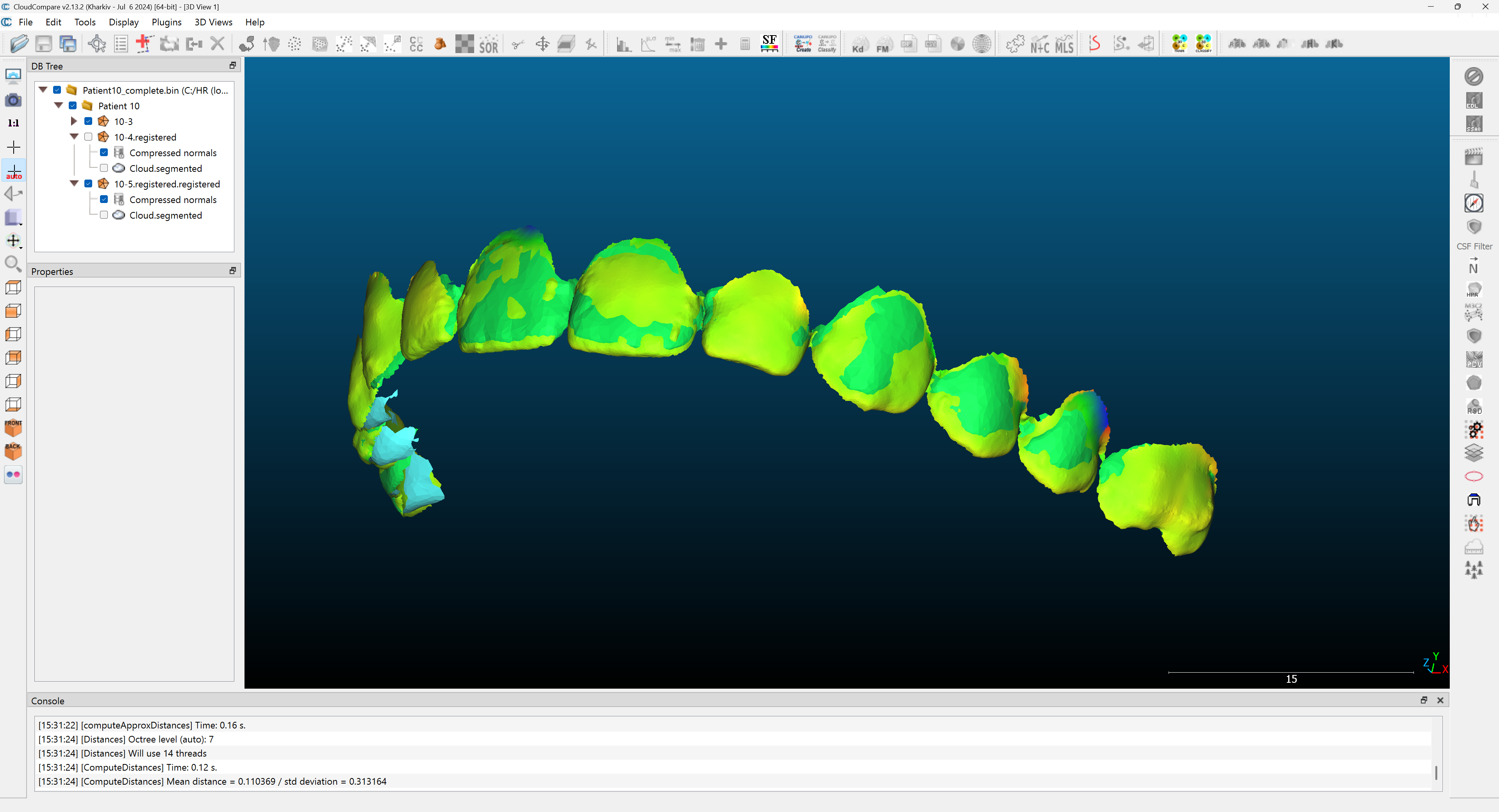

I am also using CC to register dental models and perform a ICP on the vestibular surfaces that I extract from dental models using CloudCompare. (see Image)
I works really great for me, but maybe as an addition to this topic (and since I am also an orthodontist using CC ;) I have the following question: is it possible to restrict the ICP analysis to certain areas of the two compared models (mesh)? When extracting the vestibular surface of the compared dental models, there will always be a certain deviation between the border of the resulting models. Im thinking about an option to exclude a defined amount of the outer perimeter of the mesh from the analysis. I am trying to quantify the deviation between the flat vestibular surfaces of the models, so I need to get rid of the deviation in the ICP that is caused by the uneven extraction of the vestibular surfaces or the gum (which is why I cut out the surfaces).

While it would be easy to ignore the points with the largest distance and restart the ICP process (with the 'Edit > Scalar fields > Filter by value'), it's not as simply with meshes. Either you remove the parts you want to ignore manually (with the scissors tool or the Cross section tool). Or you try your luck with 'Edit > Scalar fields > Filter by value' in case your mesh has a high density. Last option is to convert the mesh to a cloud (Edit > Mesh > Sample points).
