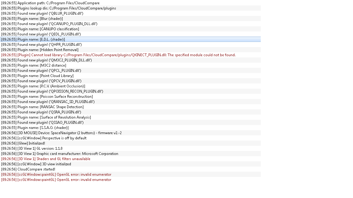

Daniel, Just loaded Version: 2.5.5.2 [Windows 64 bits]. I continually, in the console, get the following error [ccGLWindow::paintGL]OpenGL error: invalid enumerator and when using the point picking tool the display box is empty. Thanks Mike.

Interesting. What is your graphic card? And what is the OpenGL version displayed in the console on startup?

Daniel, I was using remote desktop and so Microsoft drivers were being used rather than the systems NVIDIA graphic cards, which was disabled. Plugged in a monitor to the computer and use it diectly and it works fine! So the issue is with Microsoft drivers over remote desktop in the latest version of CC if that helps. Mike.

Daniel, Here is a copy of the consule under remote desktop. Mike.
Screen dump of consule.
Re: Point Picker Display Box and OpenGL Error
When using CC in remote desktop, what was the OpenGL version used? I bet it must be pretty low... We may not support version lower than 2.0 properly. And of course, those kind of 'drivers' are more likely to be buggy...

Okay, I never tested CC with an OpenGL version this low. I guess there's several things that may fail...

This may be helpful. I just installed the new beta version of CC 2.6.1 and was getting the OpenGL enumerator error seen above. I updated the graphics card driver and the problem has gone.
