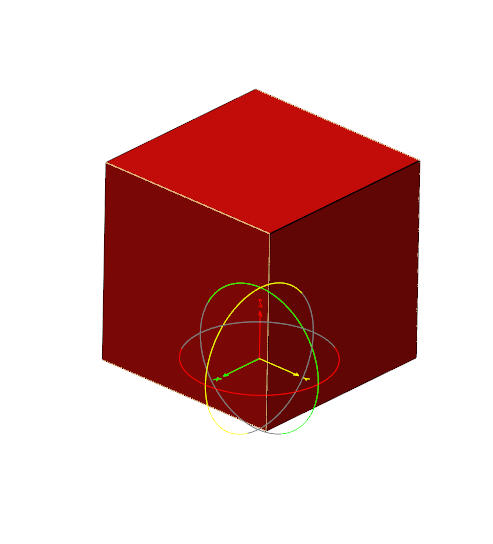

1. Rotate/Translate Handles.
For me, one of the most commonly used functions in CloudCompare is the translate/rotate tool. This is a really quick way of coarsely aligning two point clouds or a point cloud and a mesh. I think this tool could be improved if there were some on screen 'handles' that a user can manipulate to push/pull the object in 3D space. This would then leave the left and right mouse buttons free to orientate the view, and eliminate the need for the pause button.
