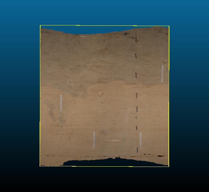

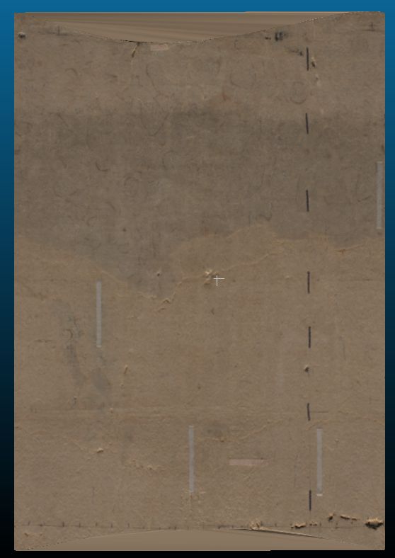

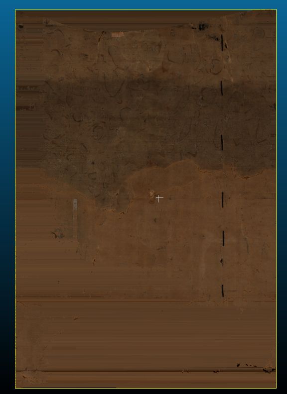

so maybe images are clearer to explain what I obtain :
original mesh with texture :
unrolling previous data with cylinder gives :
observe the strange horizontal lines in the left and bottom part of the image
I precise that I tried with different radius for cylinder thinking it was a probleme of intersection the mesh with the cylinder, but it doesn't help
unrolling only the point cloud and remeshing gives :
The geometry is OK, but the image quality is poorer
Re: unroll texture
I confirm that meshes are not handled properly when their vertices are unrolled (especially because some triangles are torn apart from one side to the other). It can only work in some very specific cases (if the mesh is opened and you are lucky).
Otherwise, if you only unroll the vertices or if you use two few sample points (and remesh) I don't think it will be very clean indeed. I was more thinking about sampling a huge number of points (i.e. 50 or 100 M) and then using the unrolled cloud "as is" so as to avoid any visual artifact. But of course it can only work for display.

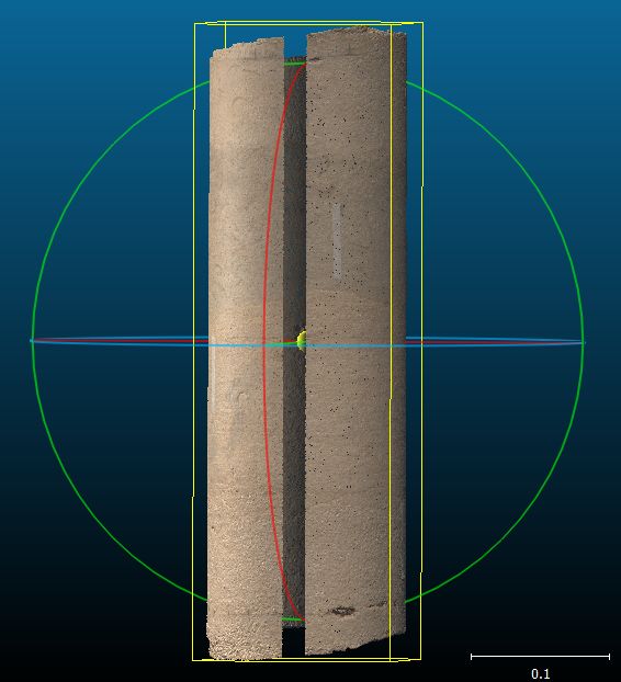

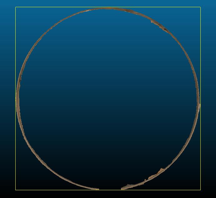

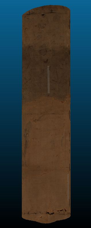

From your posts I got ideas and I found a trick that does the job. You need to cut a vertical band of the core (cylinder) in order to unclose the mesh. The location of the cut is important, so make different tries to find the good one.
For our needs this will be good enough even if it's a little tricky.
Here are screenshots of the cutted core and the unrolled result.
