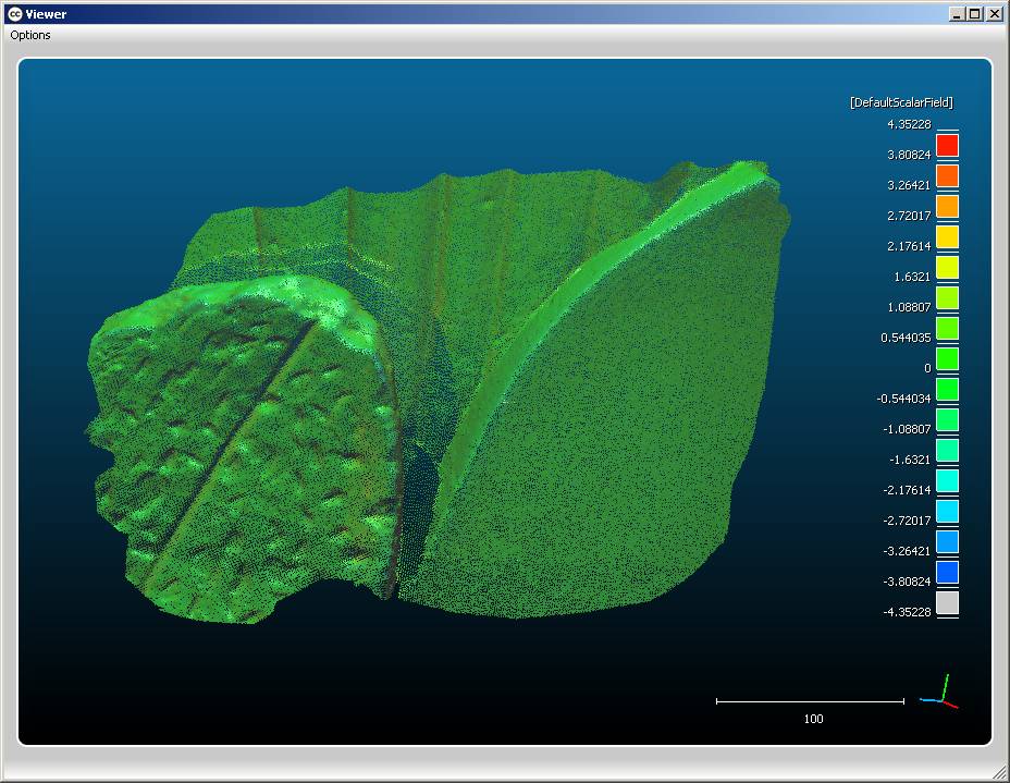

Just a quick post to present a new tool in the CloudCompare family: a standalone viewer for simple and easy visualization of 3D entities.
The main aim is to provide CloudCompare users with a tool that can be easily shipped with the data they have processed in order to share the results with other people not necessarily interested in or capable of using CloudCompare.
Its main features are (as planned today):
- full window visualization with no toolbar, no icon and a single menu entry ("Options")
- automatic guess of the type of features stored in the file to minimize the need for intermediary loading dialogs (particularly for ASCII or PLY files)
- integration of existing "OpenGL filters" plugins (EDL, SSAO, etc.)
- support of CloudCompare features: scalar field handling, display of the color bar, etc.
- eventually, a new file format will be created:
  • to allow metadata to be saved alongside 3D entities (such as the color-coding parameters of scalar fields, their names, maybe distances measured between points with the point picking tool, etc.
  • with the option of making a 'read-only' file to prevent the person receiving the data to modify it (even with CloudCompare itself). The intended use is to distribute data to customers for preview only, for demonstration purposes, etc.
CCViewer - prototype
