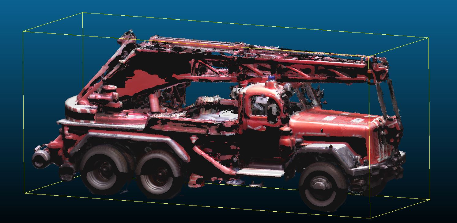

Thanks for your answer! I'll try that later. It seems that I'm a patient waiter... but I just wanted to see how long it will take if I don't change anything at the settings (and I've already started when I wrote the question). Well, it was about 6.5 hours and now I have a result to show... I have to admit, I'm not really impressed. Are the black parts a cause of wrong normals? Is it possible to change them manually?
I'll test the computing with different kernel radius settings, maybe it will give an better result. Do you think it could help if I perform an HPR before the computing?
- result.JPG (159.82 KiB) Viewed 17257 times
- good timing.jpg (10 KiB) Viewed 17257 times

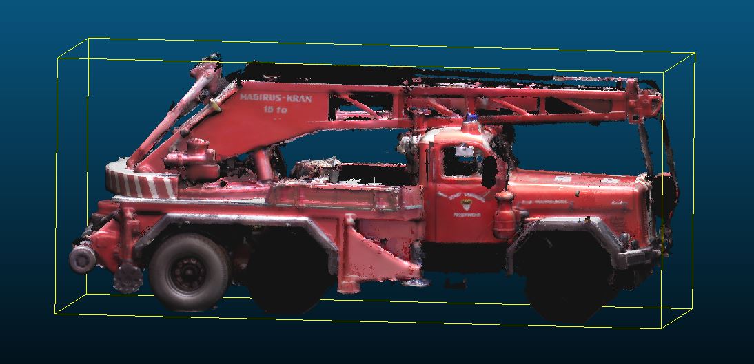

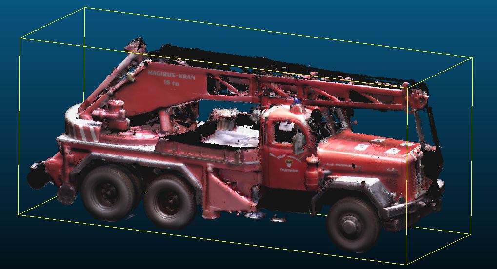

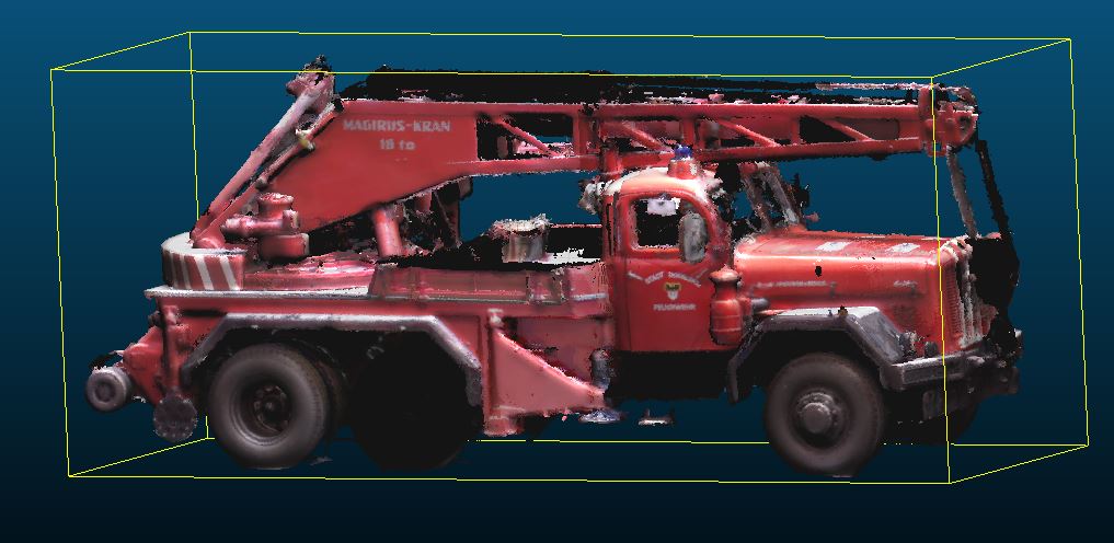

Thanks! :)
I've just tried and tested some calculations with the "Orient Normals" function and got several results. None of them is completely fine, but I'm getting close to. Special thanks for your tip with the subsampling method, I've already searched for a function like this!
I don't know why it hadn't saved the normals, maybe I forgot to calculate them when I've opened one file (it was created by combining 6 single scans). In other files this has worked pretty fine.
- new try3.JPG (90.5 KiB) Viewed 17243 times
- new try2.JPG (81.78 KiB) Viewed 17243 times
- new try.JPG (84.96 KiB) Viewed 17243 times

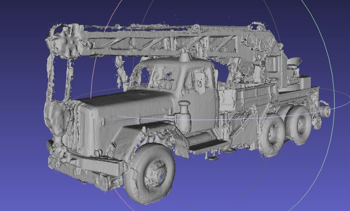

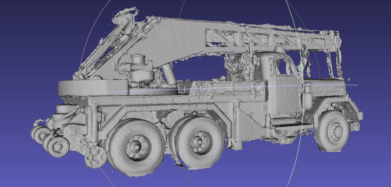

And by the way, this is what the calculated Mesh (Poisson Surface Reconstruction) looks like (with double side lightning, as some parts like e.g. the wheels, and the tow of the crane have still wrong normals)
- created mesh.JPG (54.76 KiB) Viewed 17243 times
- another side view of the mesh.JPG (55.21 KiB) Viewed 17243 times
