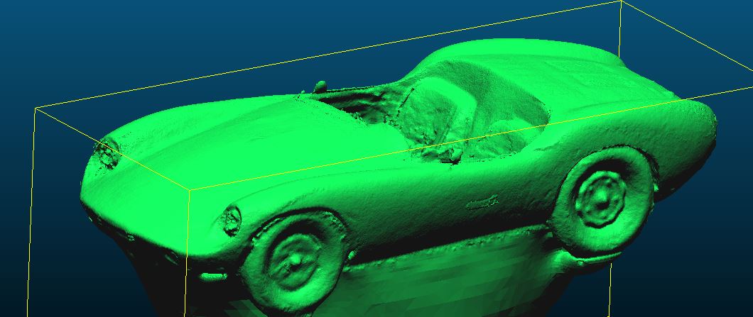

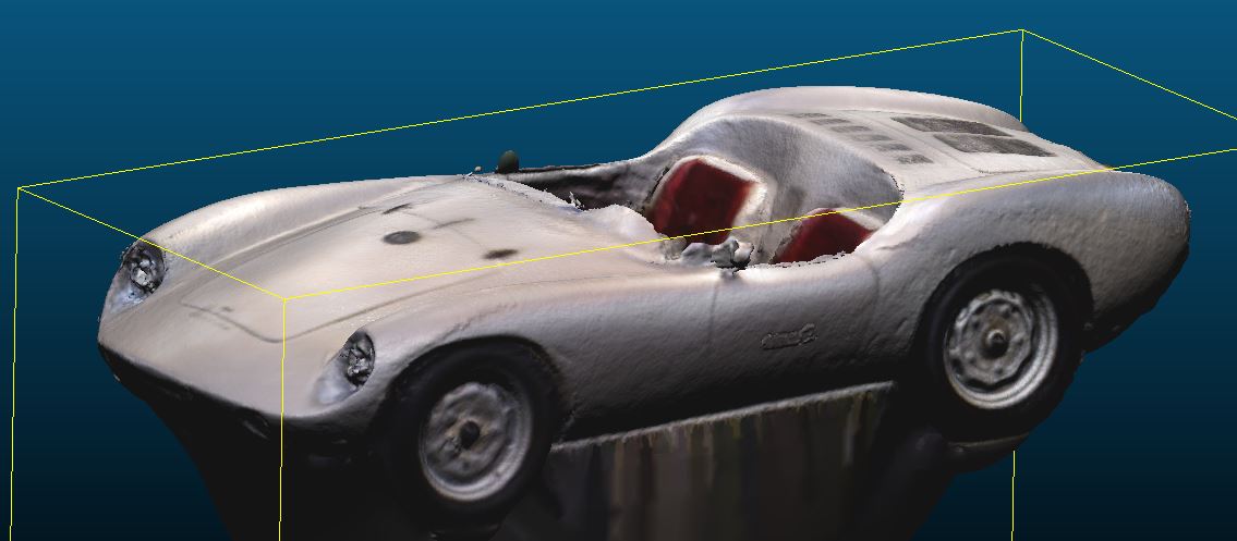

Please forgive me if I'm asking maybe another stupid question, but I'm currently struggling with another problem. When I create a mesh based on a point cloud (with Poisson surface reconstruction), I'm asked if I want to import the colors. When I click on "yes", it works and shows me the colored mesh (picture 1). But when I safe this file as an .stl and open it again, I can't see any colors at all (picture 2). Can't this information be stored in this file format, or am I doing something wrong?

Exactly, neither STL nor OBJ can save per vertex colors (especially not STL which is the worst format ever ;).
You have to save it as PLY or FBX.
